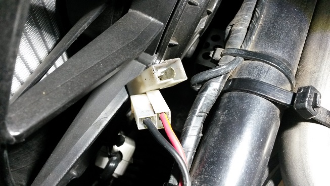

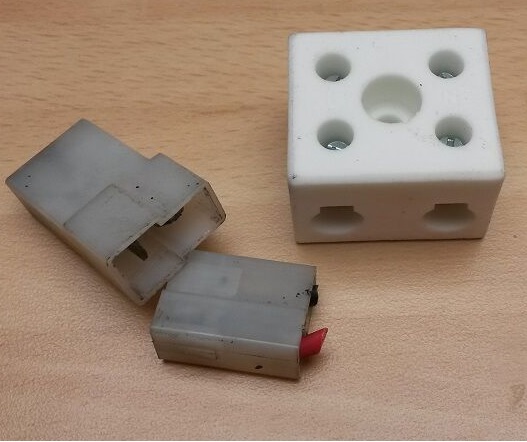

One thing to check... On the 2007 Duratec you will most probably have the 20p nylon fan connector which is dreadfully unreliable in this application. Mine failed stopping the fan from working so replaced with a ceramic connector block.

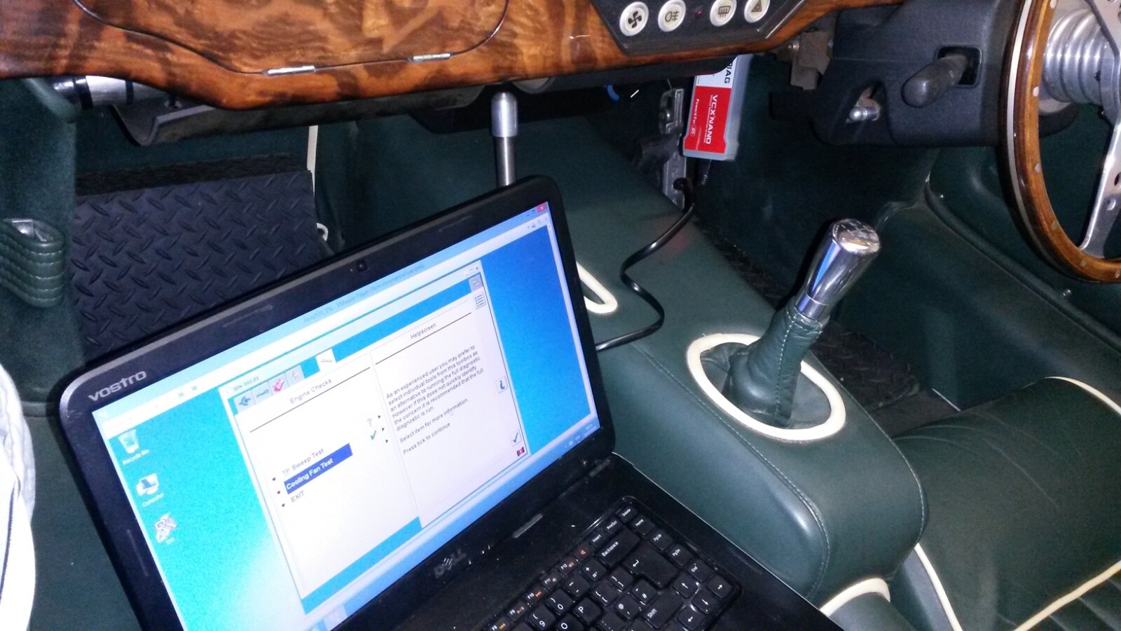

The low-speed fan kicks in around 100C and the high-speed around 105C. For what it’s worth, one of the many tricks of the Ford dealer’s OBD diagnostic software (IDS), is that it is able to run a fan test which is quite useful and reassuring.
Roger

Many thanks all. Good news!! I cleaned up the connections and the fan works. It kicks in about 98/100 and then when it drops below it the then cuts off. Is that normal, when you turn the engine off there is no fan running.
Is the above pattern normal?
Many thanks
Will
Posts: 1,702
Likes: 35
Rog Offline
Posts: 1,702
Likes: 35
Yep, the fan drops out around 94C and doesn't run when the ignition is off.
PS - if it was the connector above that you had to clean up, will you trust it again.... scared
