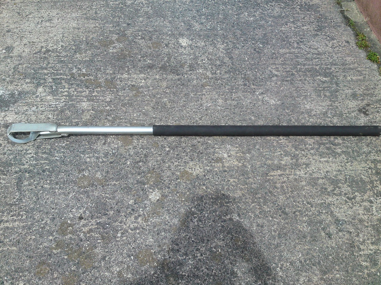

Where can I buy a VERY long spanner to fit the octagonal spinner on my 2025 Plus Four wire wheel? Hopefully one which has an offset bend to clear the fender nicely. Thanks.

Take your spanner to a fabricator and they will step it to provide the offset, then get them to weld a new scaffold pole (mine is 6' ) and strengthening brace to it and sleeve it in padded rubber - I'll post a picture later.

I got an offset spinner spanner from MGOC Spares for £62. It was around 40 or 50 cm long, and I doubled the extension and leverage by simply bolting a piece of wood to it.
