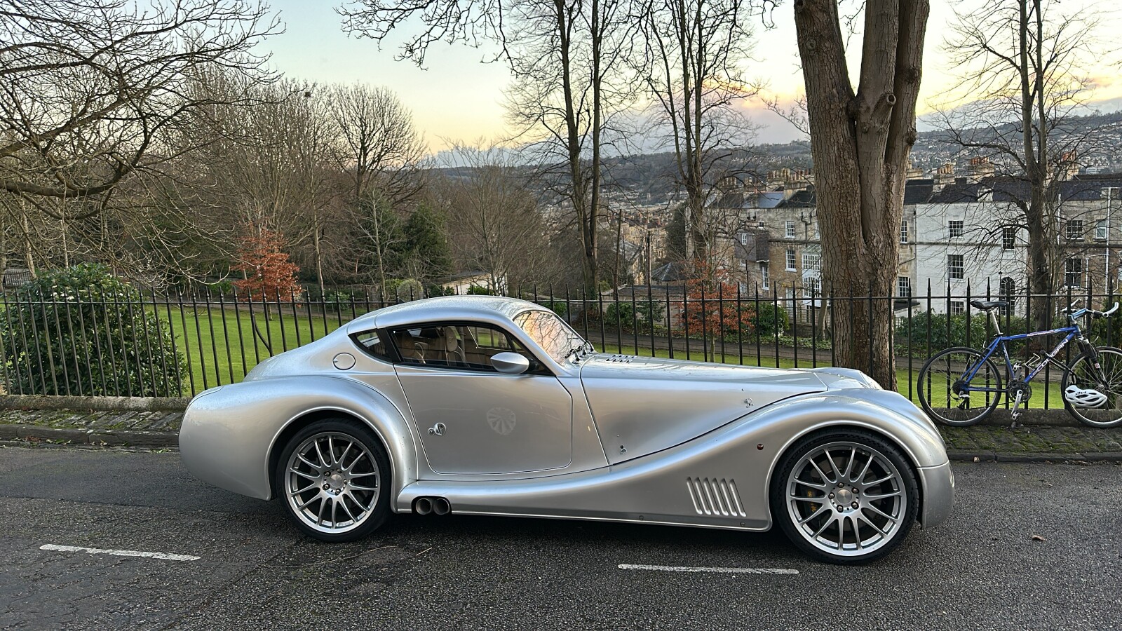

I am not certain the AI is A'ing right? Always happy to be proven as wrong.
I have a picture here of the Aero S2 (2005) which I remember being APRacing.
I found a good photo of the Coupe which was 2013 made using the same frame and (I believe) main parts as the Aero +8. These also appear to be APRacing which is as I remember them.
I know I have replaced the discs and pads on several AMG's (they do get some workout) E63, CL, ML63 etc. They were all Brembo with AMG naming on the caliper.

Coupe [Linked Image]
