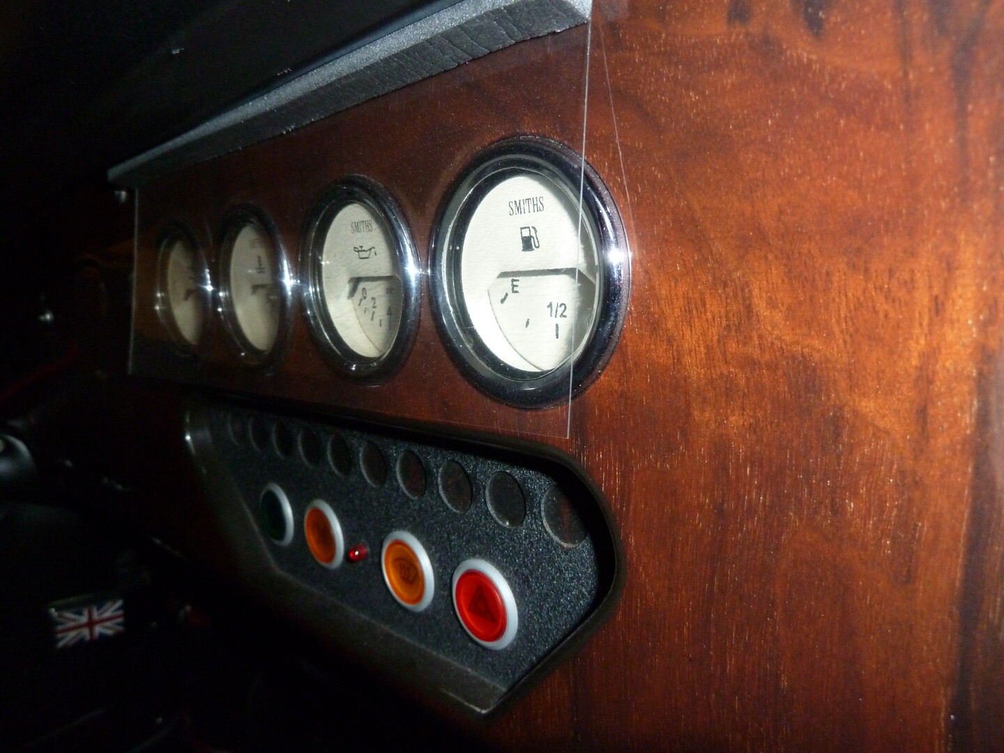

Step 5: This is more recent. I can't remember how this occurred to me, but I added a thin piece of acrylic sheet over the four small gauges. It secured under the top of the rail, using self adhesive sponge profile. In Scotland, although it wasn't cold enough for a winter test, I had no misting. But what was more interesting was that with the roof down, this thin piece of acrylic fluttered constantly as the airflow curved over the screen and buffeted it quite hard. So this is the cause of the misting. You don't feel this on the road, but the dashboard is getting a constant flow of fast moving air, and on a cold morning, this is cooling the outside of the gauges.
This was my test rig:

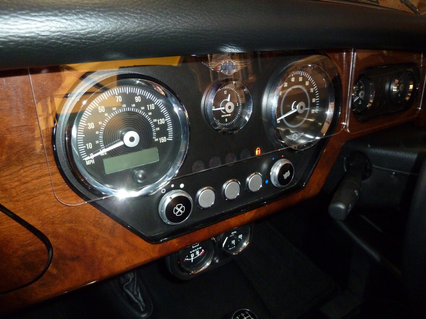

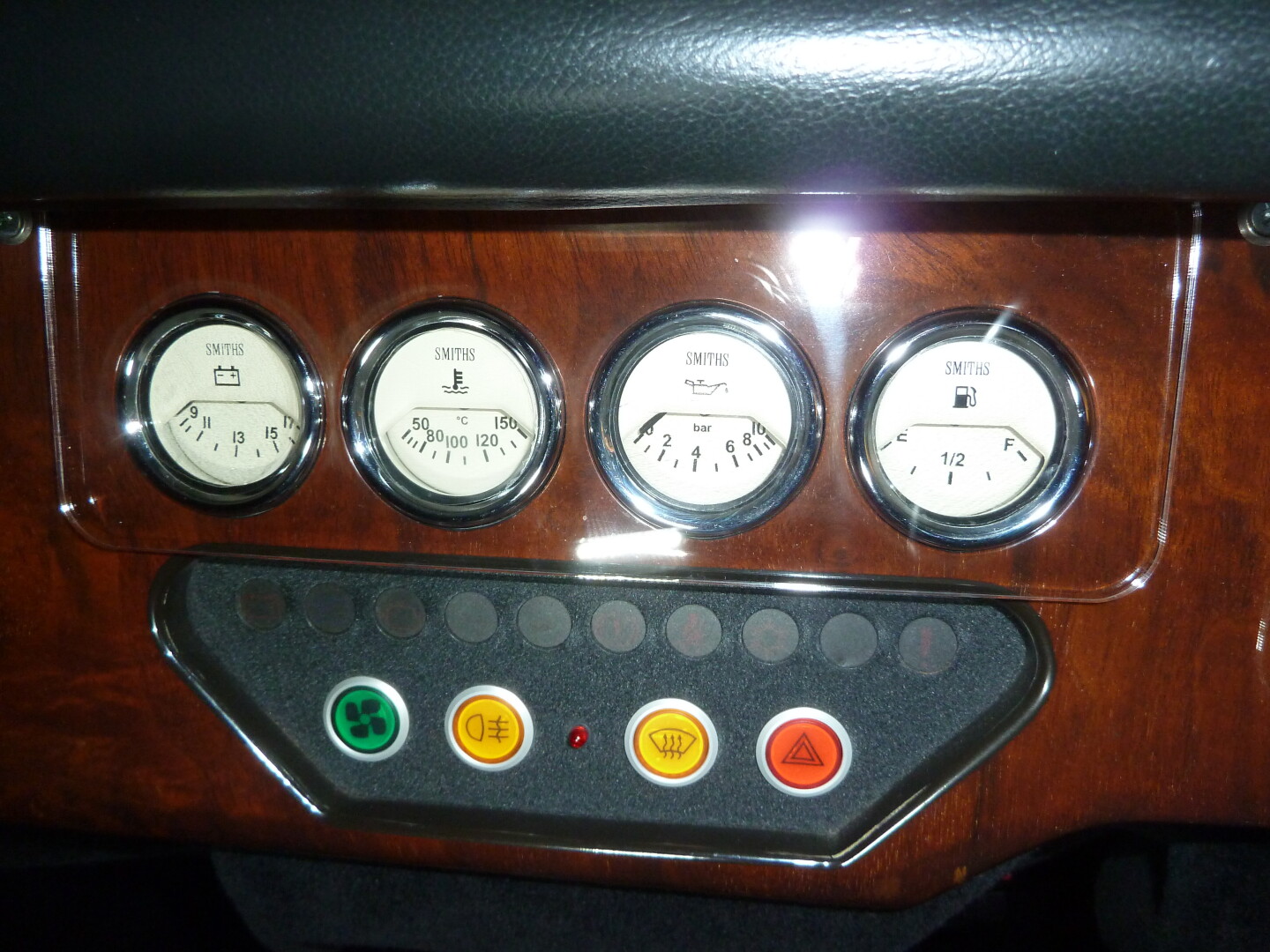

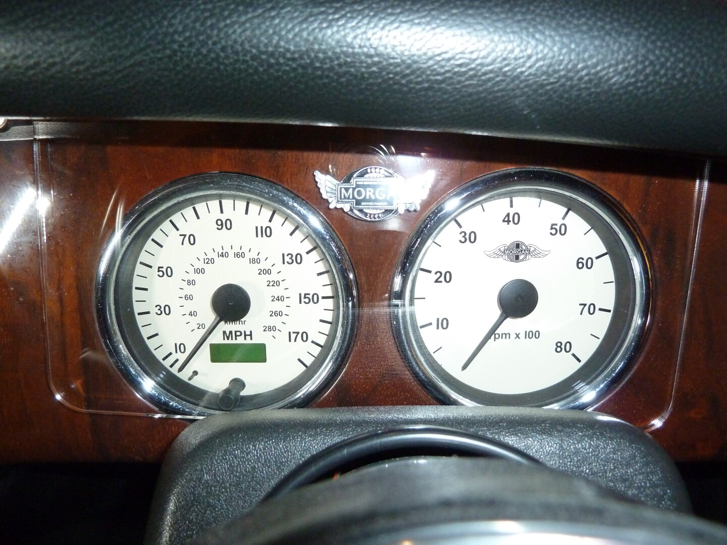

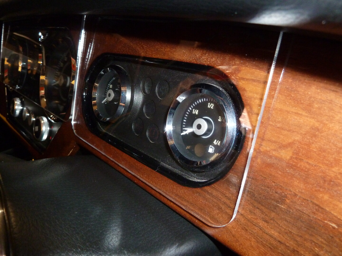

It was convincing enough for me to extend this trial into using rigid 3mm actylic, which I added this morning. I won't know how well this will work until some winter runs, but I'm hopeful.
