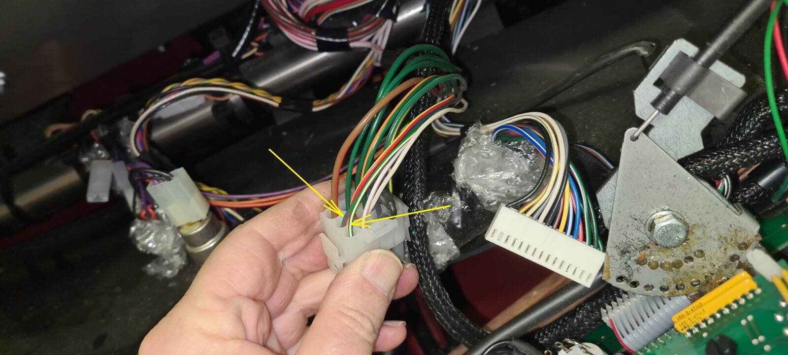

Some later cars had a little supplementary plug-in loom behind the dash with a couple of fuses incorporated. I have a dim recollection that the loom could be purchased from Morgan as an add on. I may be completely wrong but might be worth giving Mr Rutter a call?
Failing that it wouldn’t be that difficult to add a couple of 5A fuses on the N/S and O/S indicator supply wires exiting the PCB.
Wires GR90 and GW86 on pins 5 and 9 of the 12 way Dashboard PCB connector
And as always, the caveat.... Go careful modifying your car. Check everything for yourself. Don’t take my word for anything, I have no electrical credentials. exting
