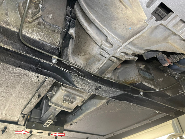

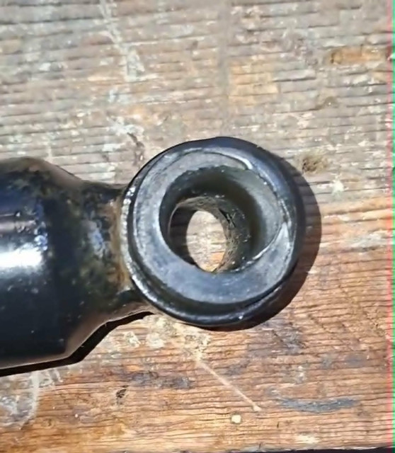

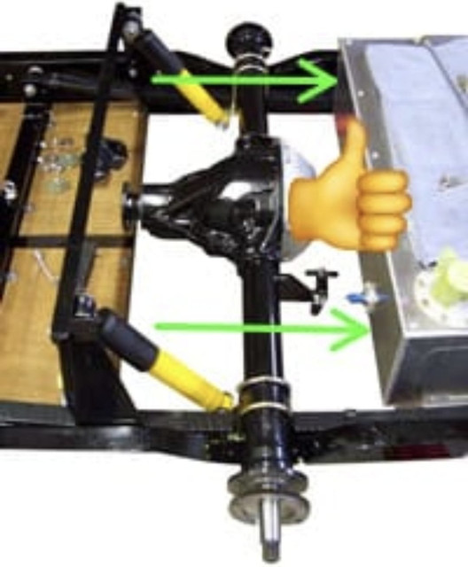

The gearbox mount is now very much Monty's low point. ![[Linked Image]](https://i.ibb.co/6cJy53S5/Gearbox-mount-nuts.jpg) I've slowly been using the road surface to machine down the two protruding 'sacrificial' nuts as arrowed above  The tyre idea is all well and good for most, however, my plan to go up from Monty's existing 185/65 tyres to 195/65s will actually only give me 2mm of additional ground clearance. Changing my already machined down gearbox mount nuts to countersunk alen bolts adds a further 8mm, so a total ground clearance improvement of 10mm. While 10mm doesn't sound like much, as others have suggested it's actually a game changer; however, I also have a pair of these to fit..... ![[Linked Image]](https://i.ibb.co/C5z9210V/YVb5Xd27.jpg) Let's call them 35mm lower damper eyelet extenders, but with a 90 degree twist  To keep it all swinging with the natural rearward axle movement, Monty's rear Bilstein top mounts it will also get these eye to pin converters..... ![[Linked Image]](https://i.ibb.co/8DY096fB/procomp-eye-pin-adapters-gl1134-gwyn-lewis-4x4-02.jpg) The new setup should completely resolve any residual ground clearance concerns, while at the same time removing the dreadful binding/twisting loads that cause this sort of thing..... ![[Linked Image]](https://i.ibb.co/7NNQDdMC/Mqa-Lx3t-P.jpg) ![[Linked Image]](https://i.ibb.co/3mx568gs/b-MNFBn-X8.jpg) ![[Linked Image]](https://i.ibb.co/RpDH4j5d/F86-q-DRE.jpg)
