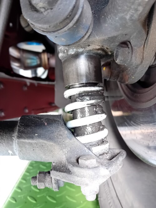

The grease will also creep out of the bottom bush, so clean that regularly too
This image is with my protective gaiter removed

Yes there is old grease sitting there. I was going to carefully clean that out.
