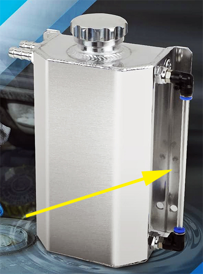

In this area, I use Mulfab expansion tanks (below). They used to come in two sizes. They are made for our cars and canted to matched the slope of the Morgan bulkhead. Very convenient. However, I like your exterior indicator of the level of coolant. I see that they can be bought separately.
I am looking for a non-plastic windscreen fluid reservoir. I too want one with an exterior level indicator. These are more complex a search than the expansion tanks as an incorporated pump is needed. And placement should avid them melting with exhaust pipe heat.NT I shall be patient until you get there.

Originally Posted by Montegue
... it only takes a quick nosey in the tank to establish all is well.
I want to avoid that. The coolant tanks are often filled with hyper-heated coolant!. Your last picture in your earlier past shows an exterior level indicator which would be great (see below). I could fit one anywhere I choose to my existing expansion tank. I would then get a matching reservoir for windscreen fluid.
Lorne
