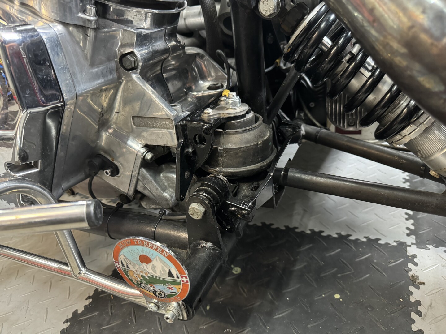

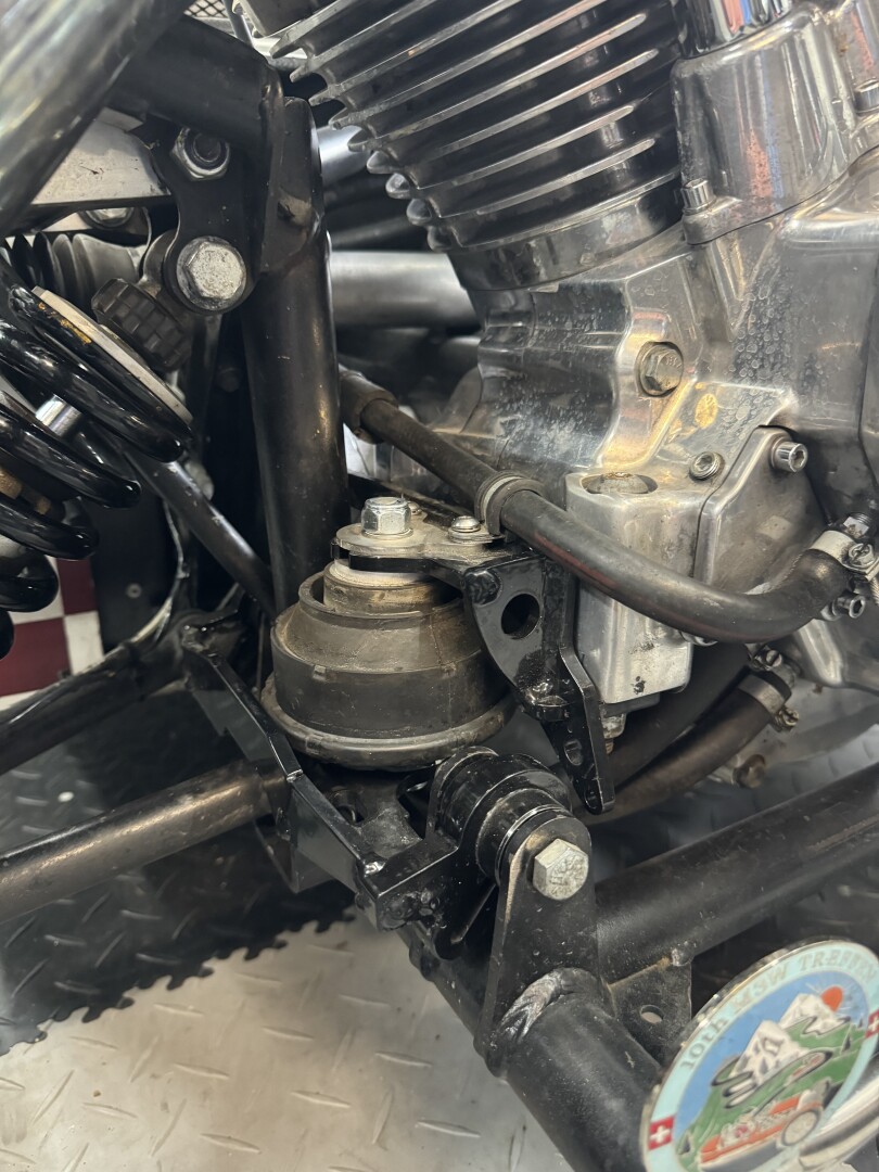

Originally Posted by Stevo666
If you want zero vibration on the mirrors and therefore less vibration felt throughout your M3W then upgrade the engine mount system with the m3wservices.com engine mounting system - it makes a vast difference.
I can confirm this.
M3W Services delivered last week our car back to Switzerland, and there's a huge difference in the vibrations.
The mirrors are now absolutely vibration-free and clear all the time and at any speed.
