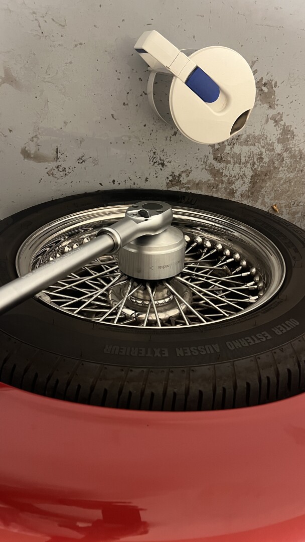

I was so preoccupied with the central screw nut that I tried your recommendation right away.
Pour boiling water over the screw nut... wait two minutes and lo and behold, the nut can be loosened.
Thank you, John, for your first-class and quick help 👍

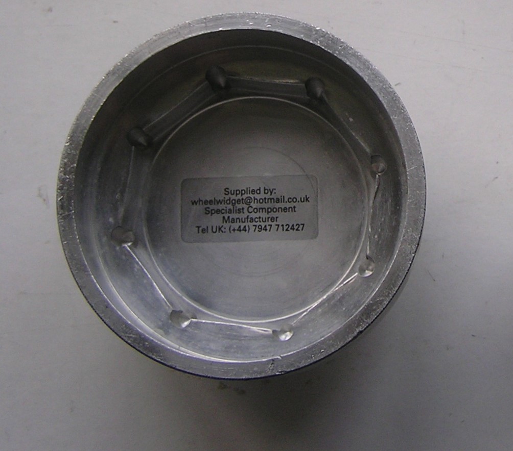

Originally Posted by MartinB60
Anyone know where to buy those sockets in the UK ?
My CX came with a flat open hex spanner & a mallet. It sits awfully close to the wire wheel rims, not the best design !!
Thanks.. Martin
Lionel Roberts made various versions for plain and "eared" spinner nuts https://franks4x4-morgantechnical.blogspot.com/2019/11/a-lionel-roberts-alloy-wheel-spinner.html, No longer available direct as far as I know, and I sold mine (sorry) when I switched to eared spinners, but they turn up on line occasionally

Mulfab make angled longer handled versions of your mm one.
I have alloys now but am keeping my mulfab and Lionel spanners for now

I made mine myself/had it made.
Brexit is unfortunately making exchanges more difficult. But if you like, I can send you a drawing via private message.
