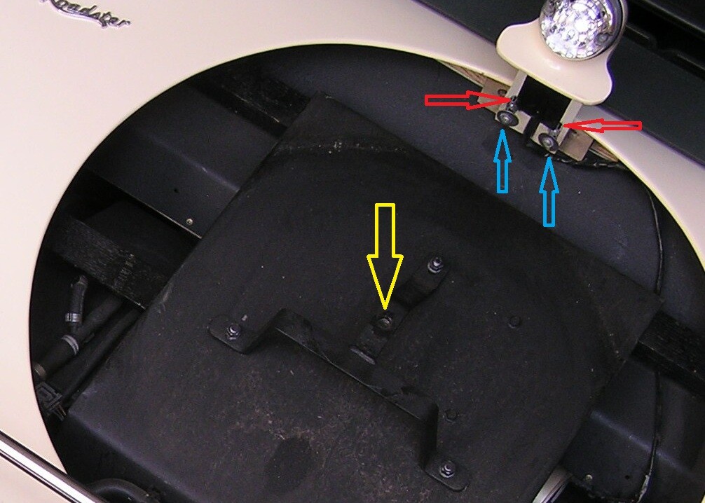

The spare wheel retainer, (don't know its technical term since it's not even mentioned in the manual - mind you, neither is the spare wheel); the thing that looks like something from the War of the Worlds with a single brake light incorporated has become loose and is rattling.
I just wondered if there is any way to tighten it without removing the luggage rack and extracting the rear wheel?
Grateful any suggestions.

Can you clarify the spare wheel carrier, ie. have you taken the spare wheel out of the car. Is it the thing that looks like the local blacksmith made it or are you talking about the cobra with the high level brake light on it. If so the cobra doesn't hold the spare wheel in place , rather its cosmetic to hold the high level brake light and as Dave has said, it's screwed to the ash frame with wood screws by a very competent technician! happy3

That's the "Cobra" Held by four erratically applied wood screws into the frame.
The only way to tighten is to take the spare off.

The thing that looks like the local blacksmith made it is the mount for the spare wheel. The "tee bar" passes through the spacer and into the threaded hole (yellow arrow). The rattly cobra is held in place with 4 screws, start with the lower ones (blue arrows) then adjust up and down and secure in place with the two upper screws (red arrows). If you have the cobra too low, the tyre will foul it as you try to position the spare. If you don't have the spacer the whole spare wheel/assembly will rattle horribly, good quality replacements are avalable on Ebay www.ebay.co.uk/itm/156078389756

Whizjet, You don't have to remove the bumper bracket bolts to get the spare off, it was "designed" well as julian said not really, to swivel outwards after you have removed the T bar and it stands vertically.... yes in the way of getting the spare out!. Much more manageable without the cobra fitted, but do-able.
