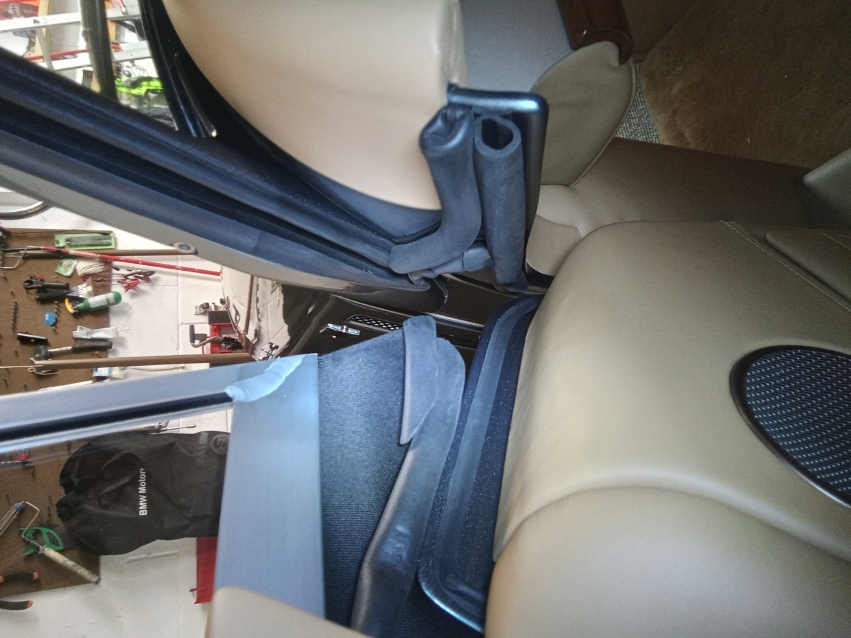

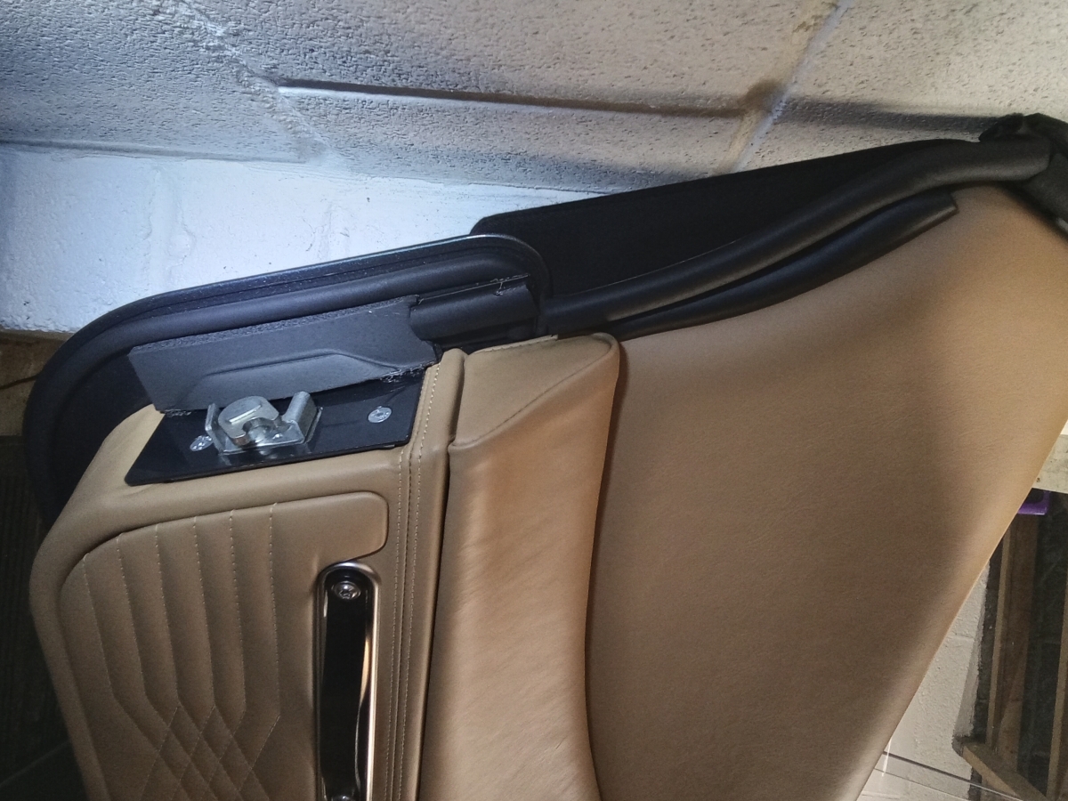

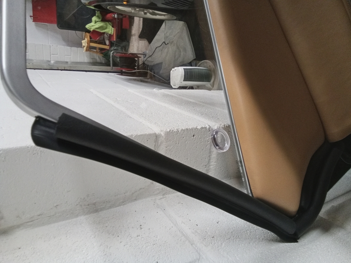

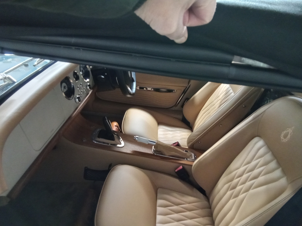

Photos of the seals added to the passenger side.
The first is the D seal added to the front of the soft top frame, above the factory seal:
Next the new seal is on the inside of the rear edge of the sidescreen:
Next photo is the rear of the door below the sidescreen, showing seals on the bottom fabric area of the sidescreen and the door panel. There was already a flat closed cell foam seal by the door catch. I don't know if that's standard, or added by Krazy Horse:
Finally, the seals on the front area of the door and on the sidescreen:

Its good to see someone taking up the baton of using neoprene seals on the CX cars! grin2
