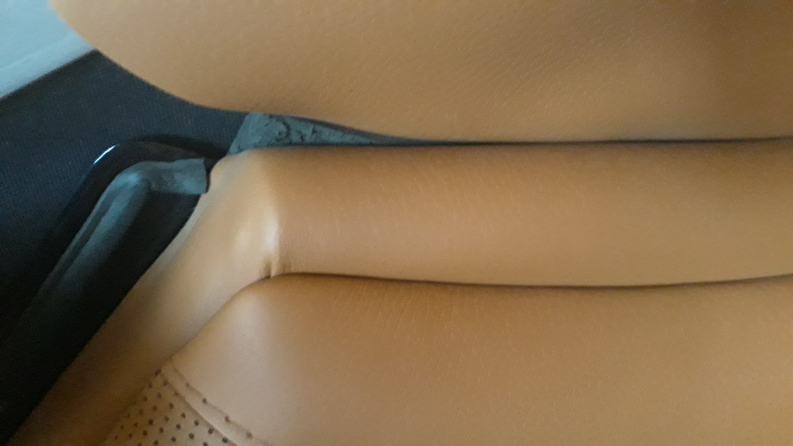

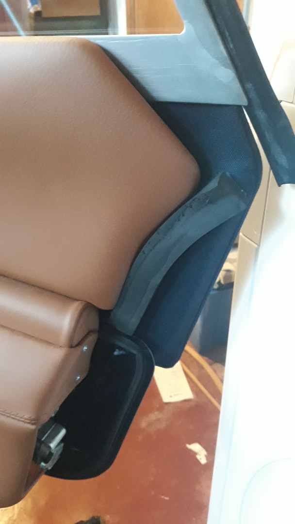

Photos of the seals added to the passenger side.
The first is the D seal added to the front of the soft top frame, above the factory seal:
Next the new seal is on the inside of the rear edge of the sidescreen:
Next photo is the rear of the door below the sidescreen, showing seals on the bottom fabric area of the sidescreen and the door panel. There was already a flat closed cell foam seal by the door catch. I don't know if that's standard, or added by Krazy Horse:
Finally, the seals on the front area of the door and on the sidescreen:
The driver's side wasn't as bad. It has some of the same seals on the rear of the door, only one on the front and nothing needed on the hood frame.
Hope the photos upload OK for you. Sorry the orientation is wrong on some of them. They are also in the photos section somewhere on the forum!

The first photo also shows a neat little elasticated pocket, attached (by supplied 3M tape) to the passenger side of the transmission tunnel. I found this at Halfords for £6!
I run the USB cable out of sight to the little pocket and store and charge my phone there.
I asked Krazy Horse how much to fit the factory version and was estimated somewhere north of £300. So I feel like I found a bargain 😁
