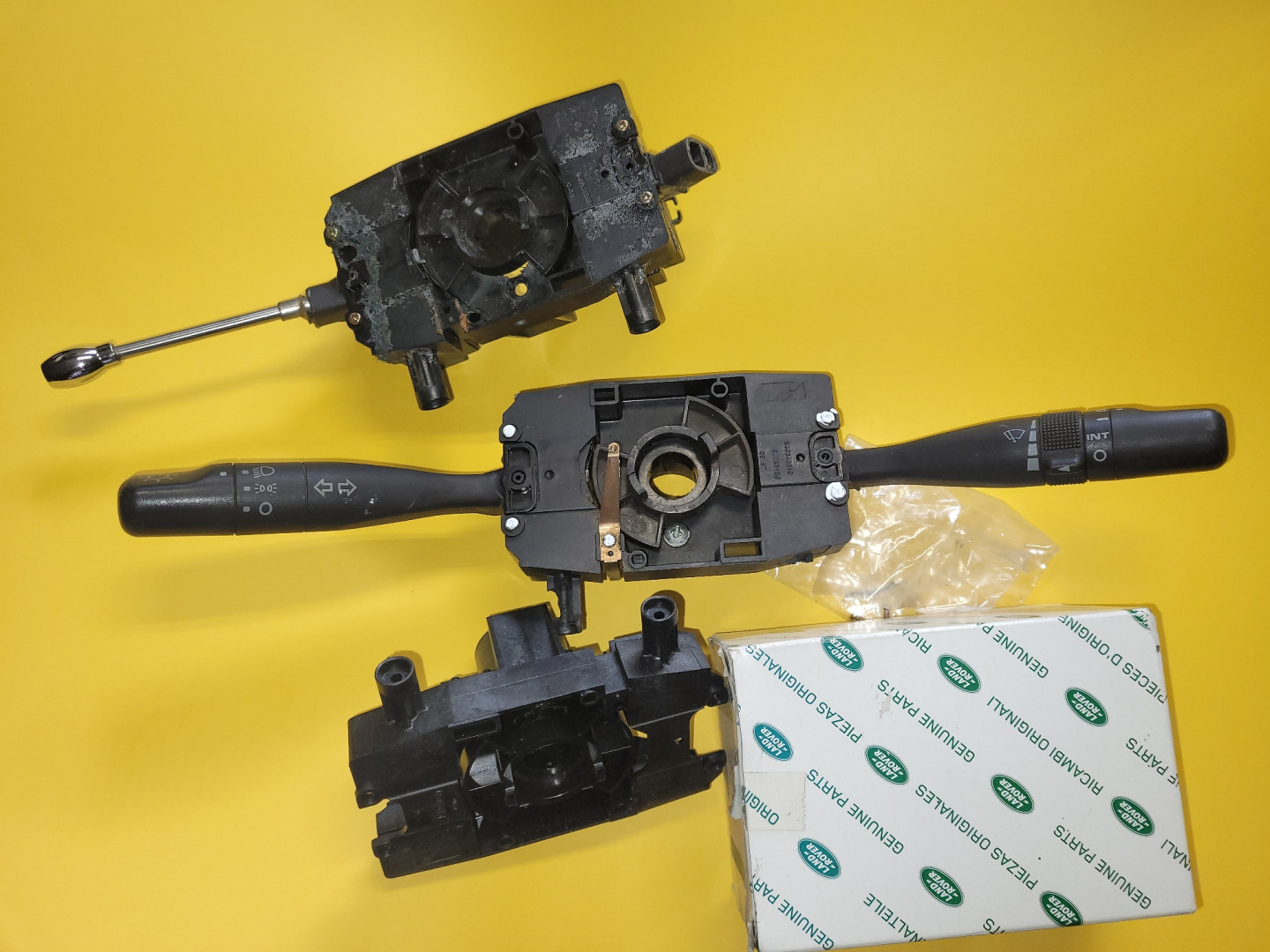

Originally Posted by Treesurveyor
So, I just replaced my steering wheel after the old boss broke, and I have broken the "pip" that keeps the stalk assembly rotating. I'm currently relying on the shroud assembly holding it in place, which allows the cancel system to operate. I'm looking I thi
nk for Discovery 2 stalks for my 03 +8, but without the rearscreen wipe/wash. although I guess one would do with rewiring?
This are the Disco 2 stalks.
I had just to replace the slip contakt on my ยด05 4/4 because it was broken and scatched the slip ring which had fallen off.
I had some spare parts in my shelf because I needet them when my bespoke stalks where broken (the silver one at the top of the picture).
My currant MorganPark stalk conversion seem to be more stable.
