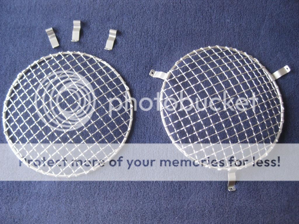

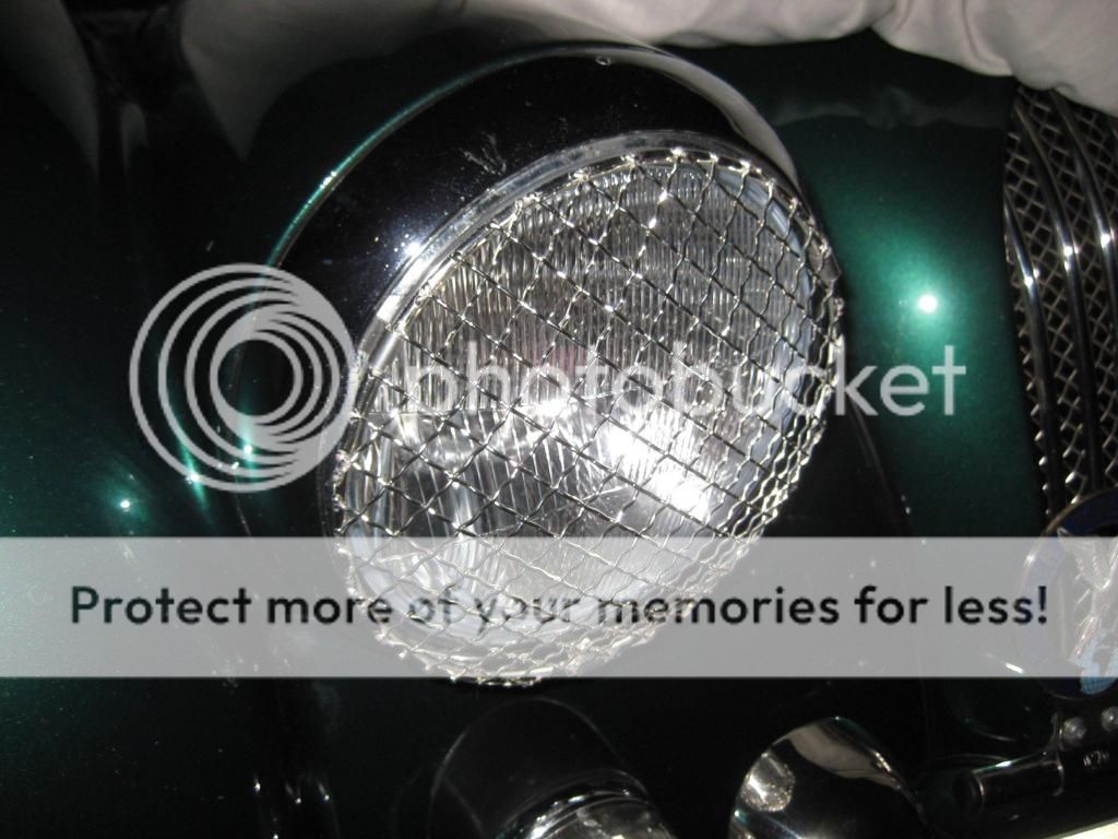

I bought a set of Stainless (no, not Chrome Plated ) on ebay for £11.00 + Postage.
To fit them I drilled out the tiny hole in the flimsey clips so that they took the 2 top screws holding the rubber to the wing. ( the ones at 10 o'clock & 2 O'clock.
I needed to change to longer length self tapping screws and to add in a 1cm spacer made from large size plastic Rawlplug (Could have used a piece of Biro Pen instead) as the clips were too short to reach the wing lamp gasket.
The lower screw (6 o'clock) one fits in line with a angle slot on the lamp metal surround and does not need the spacer. I used a small nut & bolt on this one.
Then I angles the mesh to be the same angle as the Grill Mesh and fitted the clips there.
Then I used pointed nose pliers to 'wrap' the end of the clip around the circular rim of the grill so that none can easily remove them.
They are a solid fit now.
The Grills stand off of the lamp glass just enough to get a cleaning cloth behind them.
I hope this helps
Frank
