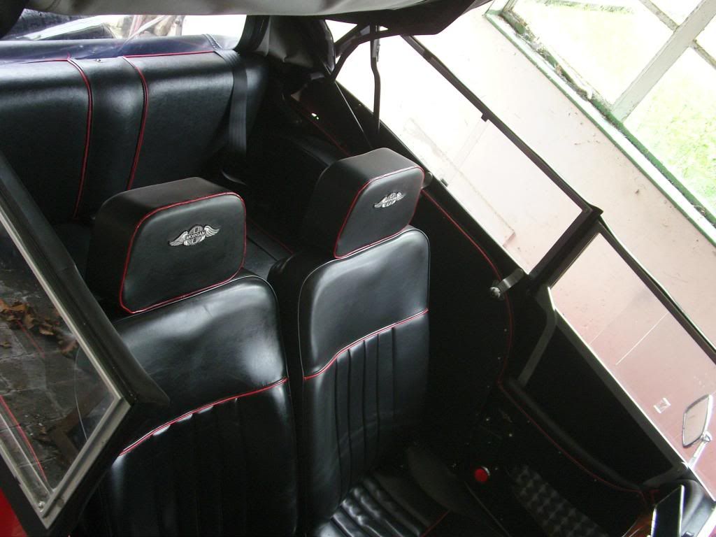

Hi I have a four seater 4/4 1982. I need to fit some seat belts in the rear.
The bench style, when the hood is down leaves the rear passengers quite exposed. Has anyone fitted just a lap strap style belt, or a three point harness?
With a three point harness where would you attach the upper shoulder strap portion? I'm not sure if the wood where the hood is attached to would be strong enough.
Any thoughts greatly appreciated
Thanks

In 1997, Dave Rutherford installed 3-point seat belts for the seats in the back of my 1983 4str 4/4. He mounted a metal frame (behind the spare wheel) that tied the connection of the seat belts to the chasis. For seat belts to be of any use, they need to be firmly connected, connecting to the wooden frame is unsafe.
I have read on this forum that Dave has retired, but there must be dealers that can do something similar.

I have a 78 4 seater with rear seat belts.The shoulder strap portion is attached to a metal bar approx 2 inch wide 1/8 thick which is the width of the area behind the rear seat It is attached to the lower part of the wooden frame by the bolts that are part of the belt swivel mounting point so you will have to drill a couple of holes through the plate and then through the wood frame; the bolt then protrudes into the space behind the spare wheel where you can tighten the nut. the holes are about 6 inches from each end.The plate spreads the load so is quite sufficient for the wooden frame.Hope this makes sense.

Harness bar is available from New Elms, Tim bought the rights to most of David Rutherford's engineering solutions. It's easy to fit and is not overly intrusive.

Lap belts NO
Fixed position three point belts in mine
I'll take some pics and post them

Stevemag,
How are your three point seat belt fixed? Especially the shoulder strap?
