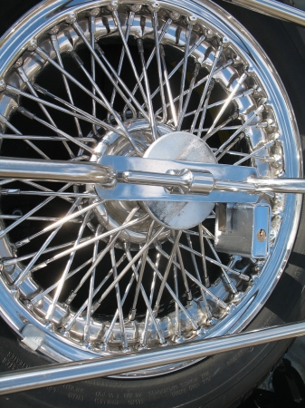

I think here is the place to show also a picture of my solution!? thinking
[img:center][/img]
Please find some more pictures in this Forum:
http://www.talkmorgan.com/ubbthreads.php/galleries/263459/Details_of_spare_wheel_secure
Best regards
