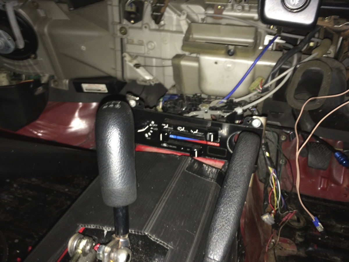

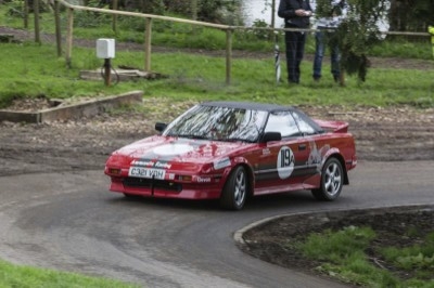

First pic is at Wiscombe last year for those that do not know the car.

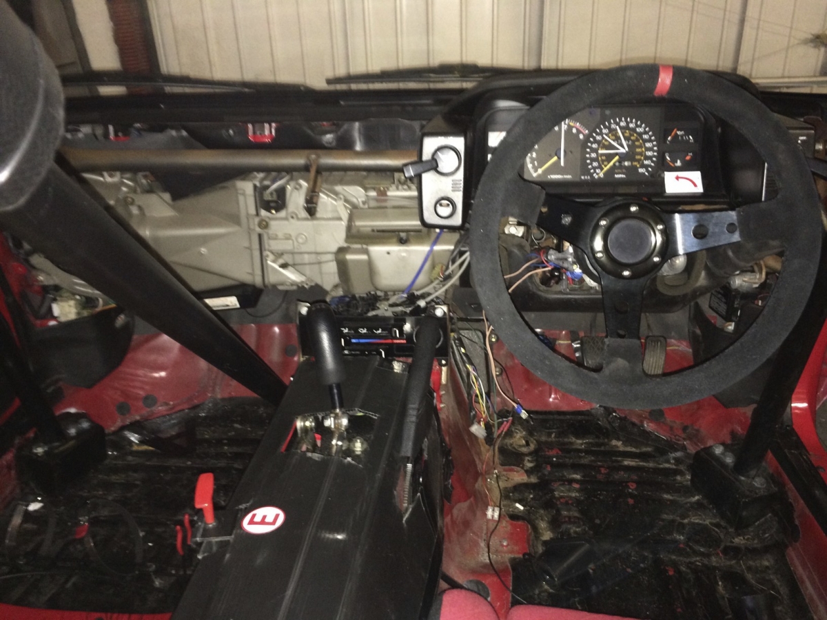

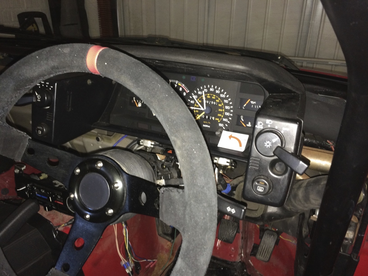

the next 3 are after me removing the dash and re-positioning the heater/vent controls for know.
Need to tidy up some wires and cover the heater controls with some black core.
NeilM is ordering some polycarbonate for the glass replacement, this will be tricky as have to heat bend the side windows. Thinking of removing the petrol tank and putting a small race one in the rear boot to save more weight. Also going to investigate the bumpers under the plastic cover, could be worth honeycomb drilling or removing if we feel brave enough to loose them altogether. I am going to hunt for some front GPS wings as well.
