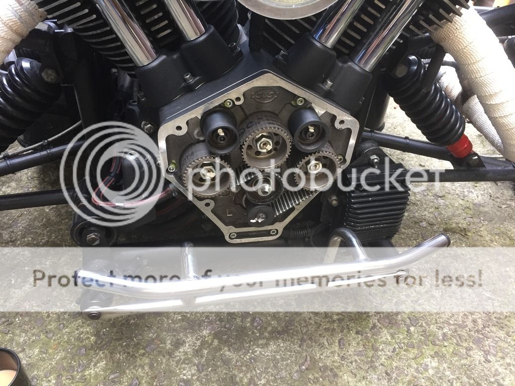

Found a way to get at these pictures while at work !
This is my car with the kit fitted. If you zoom in on the drive pulley bolt , you can see its not a torx , its a fancy hex head not sure what the proper name is.

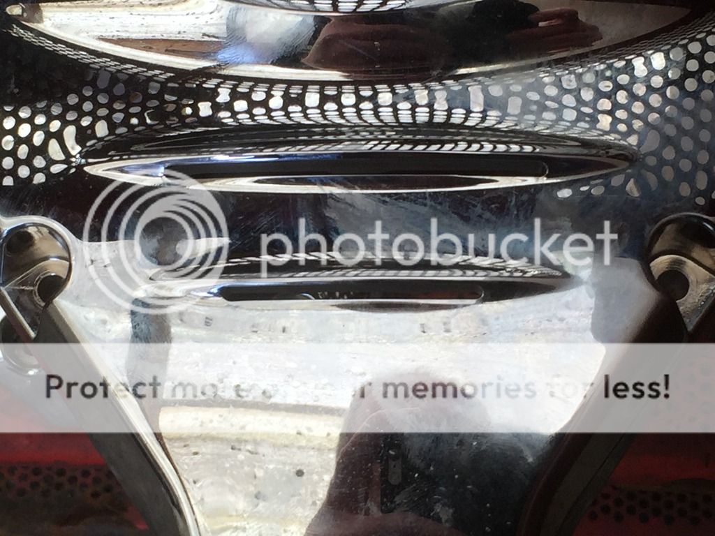

This is the new timing belt cover with the slots. Looks pretty cool I think

Good pictures! I notice that all the bolts have witness marks which is a really nice touch. I think I'll pull the cover, check the pulley bolt and put a paint blob on it. It hasn't moved as far as I can tell in 13,000 miles but this would be a way to be sure nothing destructive is going on down there.
