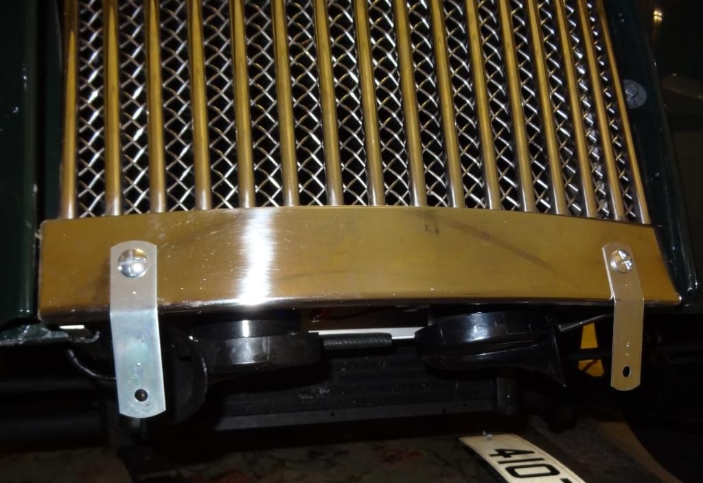

Decided to lower the number plate by about 75mm (3inches) so mounted some brackets to lower the plastic number plate mounting. Photo shows these and you can see the damage to centre of lower radiator.

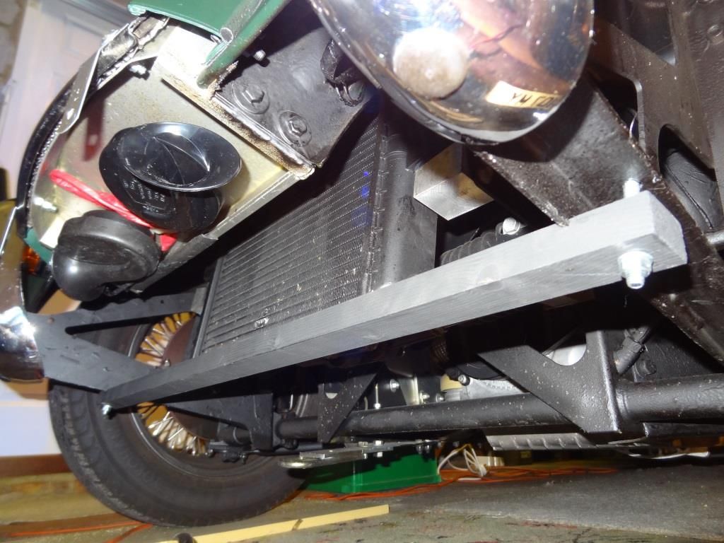

Next made a simple wooden (sadly not ash) cross-member to mount on the over-rider brackets.

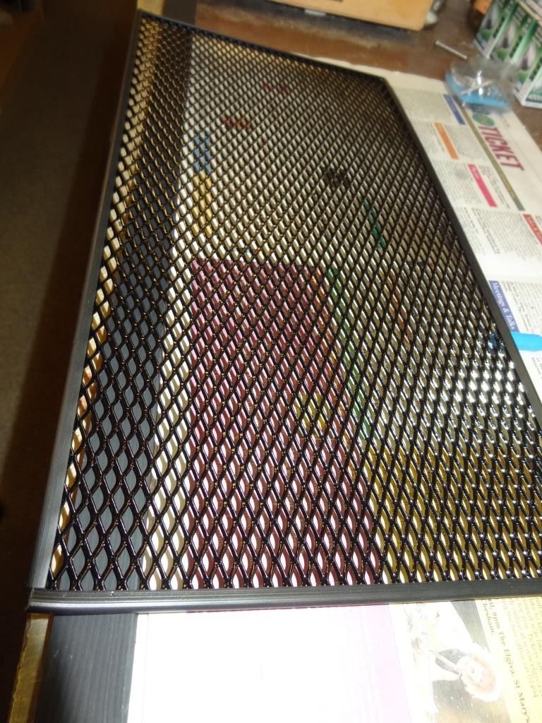

Using some steel mesh made a grill 500 x 250 mm and sprayed it black. Put some rubber trim around the sharp edges (same stuff as around the plastic number plate box)

Mounted the wooden cross-member using 6 mm stainless bolts and existing holes in the over-rider supporting brackets. This also made the over-riders more sturdy and less wobbly.
Number plate holder and attached grill then mounted as shown (bolts on wooden cross-member yet to be shortened).
This (hopefully) will prevent any debris from the road being thrown up onto the radiator. It has also strengthened the number plate holder.
