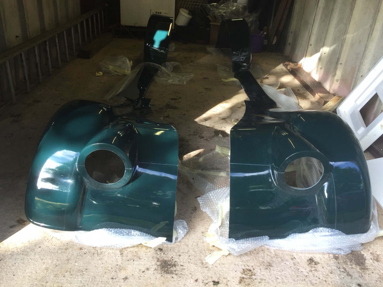

To revive this thread, I collected my wings from Sid Watson today. He has got an extremely good match to my Brooklands Green in the gel coat, so much so that I think I'll just bung them on and see what it looks like rather than bother to get them painted first.
They are lovely quality, I'm very pleased with them - and at way less than half the price of a set of alloy wings, thye make good financial sense. They just need a bit of gentle rubbing down and polishing to get rid of the seam line from the 2-part mould, and drilling for all the lights and other fittings. That should keep me quiet over the winter!

Lord Unstone's looked great in red gell coat.
That's a nice winter project.
