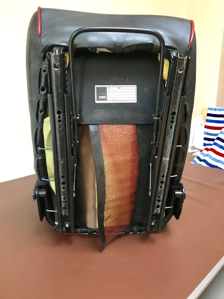

Well as there is no America's Cup racing on tonight, thought I would repair my car seat

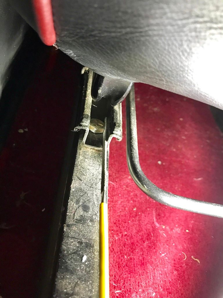

Removed it from the Mog - that was a hard job - bolt heads spinning where it was inaccessible to get a spanner in but overcame it by jamming a metal file in the chair runner - you can see it's yellow handle in the photo
The reason for the saggy bottom is because the rubber mesh that forms the bottom of the foam (is it called webbing or a diaphragm ?) has split neatly in a straight line letting the foam seat padding come out
My idea for a fix is to put metal eyelets in each side of the spilt rubber and lace up like a shoe
Here goes (TM silence for a couple of hours)

Stewart, I found the same with my seat mount bolts spinning. I have a small Stilson style wrench that fitted into the channel and locked the bolts. When refitting I used socket head bolts so no spanner needed.
It's a reet pain isn't it ?
My tool set or knowledge isn't that comprehensive
Could have done with longer arms as well

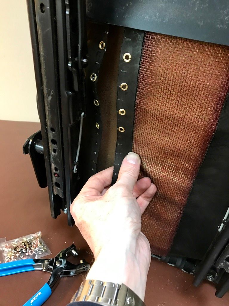

Stewart S #453786 07/06/17 06:44 PM
Well so far so good
The eyelets are going in nicely
