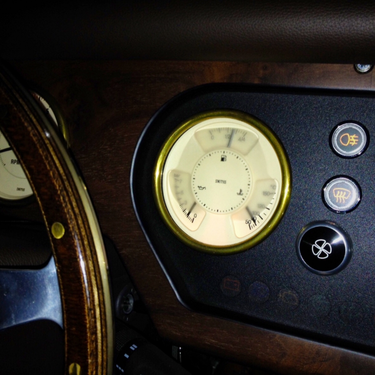

I've never driven a Morgan before and I was quite surpised to see misting in two out of three gauges. However this seems to be a known issue:
Maintenance and Servicing: Workshop note - Misting gauges
Is this a common issue or a rather rare occurrence?

It's very common. so much so that if one's instruments don't mist up it's a cause for comment.
The causes and possible solutions have been discussed for generations, but no-one so far has come up with a definitive explanation (beyond the obvious, which is that there's warm moisture laden air inside the instruments which is being cooled to its dew point by the cold air in the upper part of the cockpit).
DaveW is currently drilling holes in his instruments in a strategy to promote better air flow. I've put in LED bulbs in an attempt to reduce the temperature inside the instruments. Others are toying with alternative solutions like wiring in additional fans.

The smaller gauges are worse than the larger ones. My large ones only mist in extremely cold weather when the roof is down. The fuel gauge seems to generate the most heat/condensation.
It's also worth knowing that this isn't just a Morgan thing
A quick search on the internet reveals that just about every classic car forum where the vehicles tend to be open cockpits have similar posts.
the ingredients are:
open cockpits
glass fronted instruments (hence why modern polycarb intrument fronts in open cars dont do this)
weather- very cold mornings and then driving in warmer conditions
There are two really good things about this happening: 1. You are alive; 2. you are driving your Morgan
