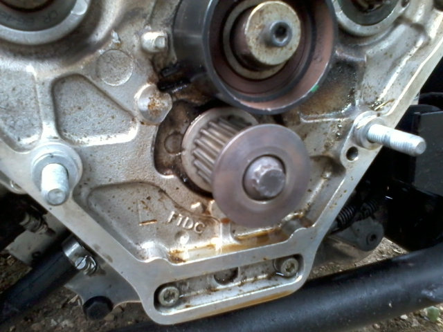

I am in the process of upgrading my cams and wanted to double check what direction the pinion bolt turns to loosen it. I don't want to break anything and the S&S manual does not seem to say. Also I am assuming I don't need an air impact gun and a traditional ratchet/socket combo should work to take it off.
Appreciate any guidance on this.

Well figured it out. Lefty loosey kind of thing. Interesting though my cam tensioner circle thing is a bit dented in for about a half inch. pretty odd. Hopefully S&S will send me one under warranty as my morgan has very few miles on it.

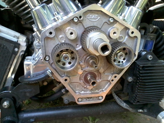

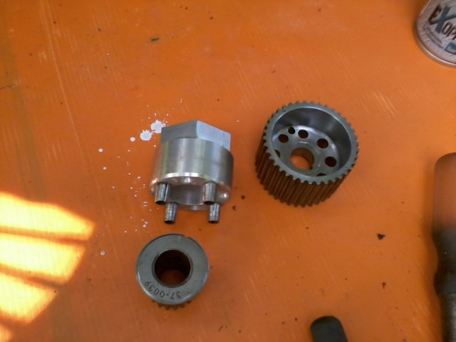

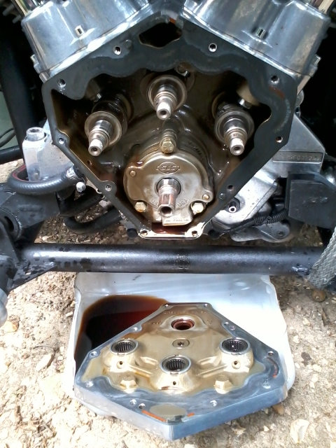

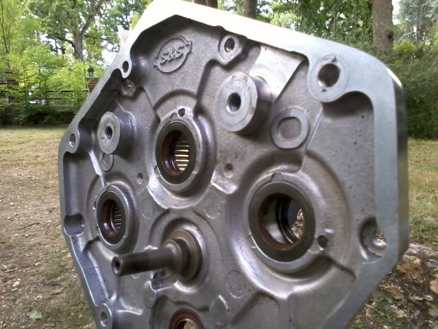

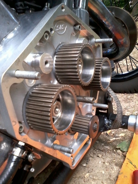

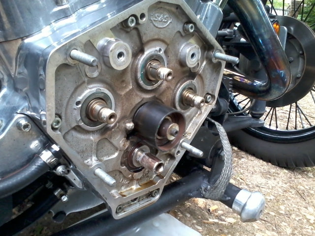

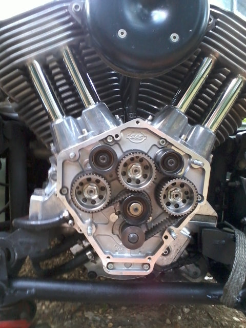

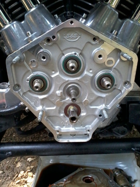

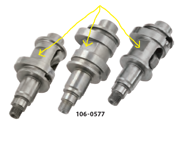

There are two methods to disassemble camshafts, the S & S method of removing the crankcase with the three camshafts to unlock the sprocket nuts.
the second method is to manufacture a suitable tool to immobilize the distribution gears without the damaged because the distribution belt does not last long with damaged gears
disassembly is relatively simple when you have the knowledge and the appropriate tooling
[img]https://zupimages.net/up/18/09/85gp.jpg[/img]
[img]https://zupimages.net/up/18/09/foux.jpg[/img]
[img]https://zupimages.net/up/18/09/b15z.jpg[/img]
[img]https://zupimages.net/up/18/09/n2b5.jpg[/img]
[img]https://zupimages.net/up/18/09/j0x1.jpg[/img]
I do not advise you to do the job yourself if you are not sure of the result, the original camshaft may work better than the following.

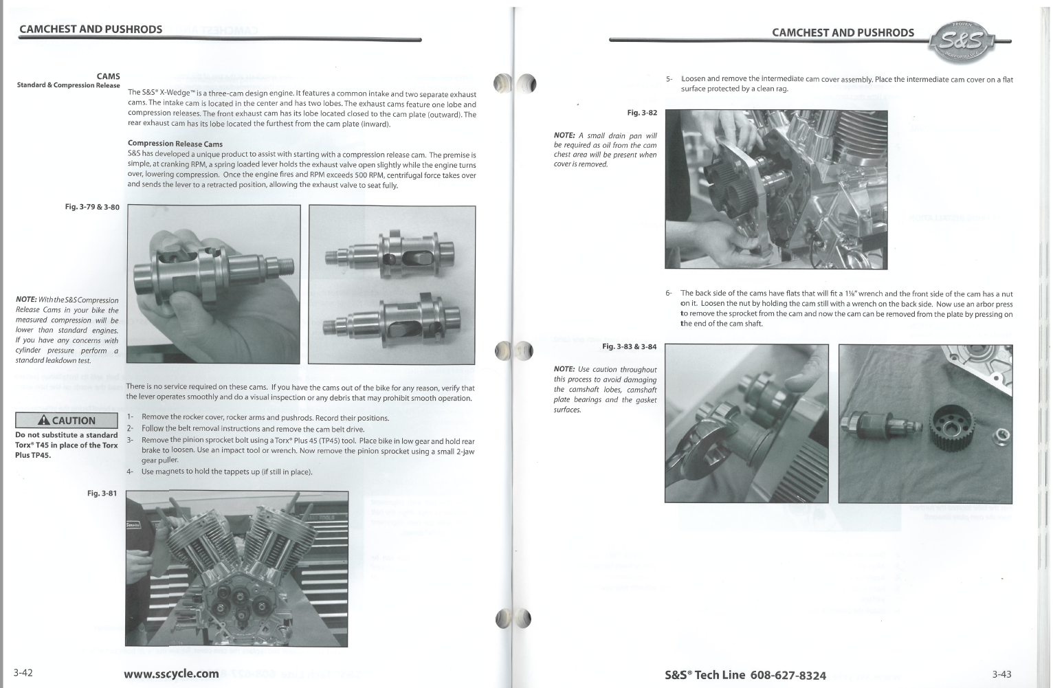

The method described in the work shop manual requires no special tools and is reasonably straight forward. Take care with the crankshaft seal, it can easily be damaged and leak afterward. You will need 4 magnetic parts finders (magnet on the end of extender) to hold the lifters out of the way. The intake and injectors currently in place will work fine. G56 pipes or de baffled stock pipes help as does a G56 air cleaner housing. An unlocked ECU with upgraded firmware from S&S would be of benefit also.
The power increase is noticeable but S&S says you don’t really feel a big hit until you start increasing the displacement. Since you say your car is low mileage, your current valve springs should be adequate.
