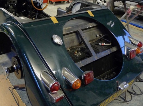

Here's mine. There's a stainless steel sheet that sits on top of the ash frame underneath the spare wheel, but that's not original AFAIK.

Mine (on RTA51R - miss that car!) - steel spare wheel mount. Top of tank visible to lower edge. No tank cover.

Thanks for all the reply's. Seems as though as it is a Morgan there are differences. Just from looking a various photos I assumed it was ply underneath the spare wheel but looking at your photo Graham it looks like a piece of sheetmetal. Please could you confirm if it was. I was thinking that the wood/metal cover protected the fuel gauge sender unit and top of the fuel tank from being flooded so not likely to be present with a disc wheel spare. Doug
Posts: 5,182 Likes: 2
Posts: 5,182 Likes: 2 |
Thanks for all the reply's. Seems as though as it is a Morgan there are differences. Just from looking a various photos I assumed it was ply underneath the spare wheel but looking at your photo Graham it looks like a piece of sheetmetal. Please could you confirm if it was. I was thinking that the wood/metal cover protected the fuel gauge sender unit and top of the fuel tank from being flooded so not likely to be present with a disc wheel spare. Doug . It's probably a crash requirement, my 79 +8 had the same. Haven't taken the spare off the 4/4 to have a look yet.
