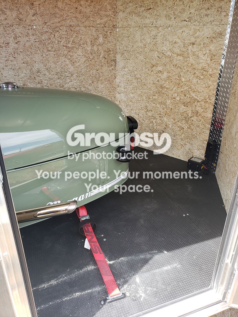

After a few months of trailer searching, I decided to go with an enclosed aluminum v-nose 7x12 trailer through EZ-Hauler. I had to order it, which was a process in and of itself, but the wait was worth it. The 3 Wheeler fits perfectly, and the drive in ramp makes loading and unloading a breeze. The V nose adds a ton of functionality with 3 wheeler, and I had some very helpful engineers work out which way it should be parked for the ideal CG & Tongue Weight. Now, it'll be ready to take on the road for some fun weekend trips!
I also changed out the headlights, after the headlight reflector cup broke on mine, and I was finally annoyed enough to change it. Lastly, some photos.

Have you hauled the M3W yet as shown in the pictures?
If so and the trailer tracks okay, you're "probably" okay.
The reason I say that is that trailers need to have tongue weight and pulling your M3W in backwards would tend to add weight behind the axle.
I borrowed a friend's trailer decades ago for my dune buggy, VW powered. I loaded it normally, nose first. As soon as I got on the road and had just a little wind, the trailer would whip back and forth and was just plain scary. I unloaded and backed it up on the trailer and the tongue weight fixed my whipping issues.
I would just say put some bathroom scales under the tongue and then see if when the M3W is loaded that the tongue weight goes up.
I'd rather be safe than sorry.
