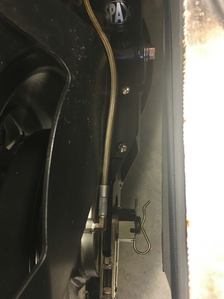

I repositioned my rear line to be tidy and straight, with the loop moved forward, behind the seat. Actually instead of a loop, it's now more of a large radius curve, and easily allows the wheel to slide back and off the swingarm. A zip tie ensures it remains clear of any pinch hazards.

Obie #621580 08/03/20 07:54 PM
Joined: Feb 2019
Posts: 3,857
Joined: Feb 2019
Posts: 3,857
Nicely done Steve!

Good idea, I’ve got to remove the boot liner again now!
And enough around the bell housing to be able to pull that line all the way forward.
