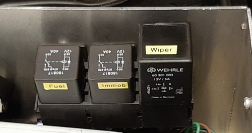

Before

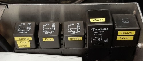

After
So for a total of £14 I now have spares being carried ‘in-situ’.

Excellent job thumbs

Very neat.

What a neat solution.
I keep two spares in the tool tray and one in the glove box!
The only breakdown I’ve had was a failed fuel pump relay. Fortunately, I was carrying a spare.

For what is worth I have a large diagram of the relay connections folded in the glove box,in case it is dark so I can swop the relay will little light.

Neat solution to carrying spare relays.

Great idea, labelling them. Incidentally, Are your fuse boxes A & B labelled the wrong way round by the factory, as I have seen on a couple of other GDIs.?
