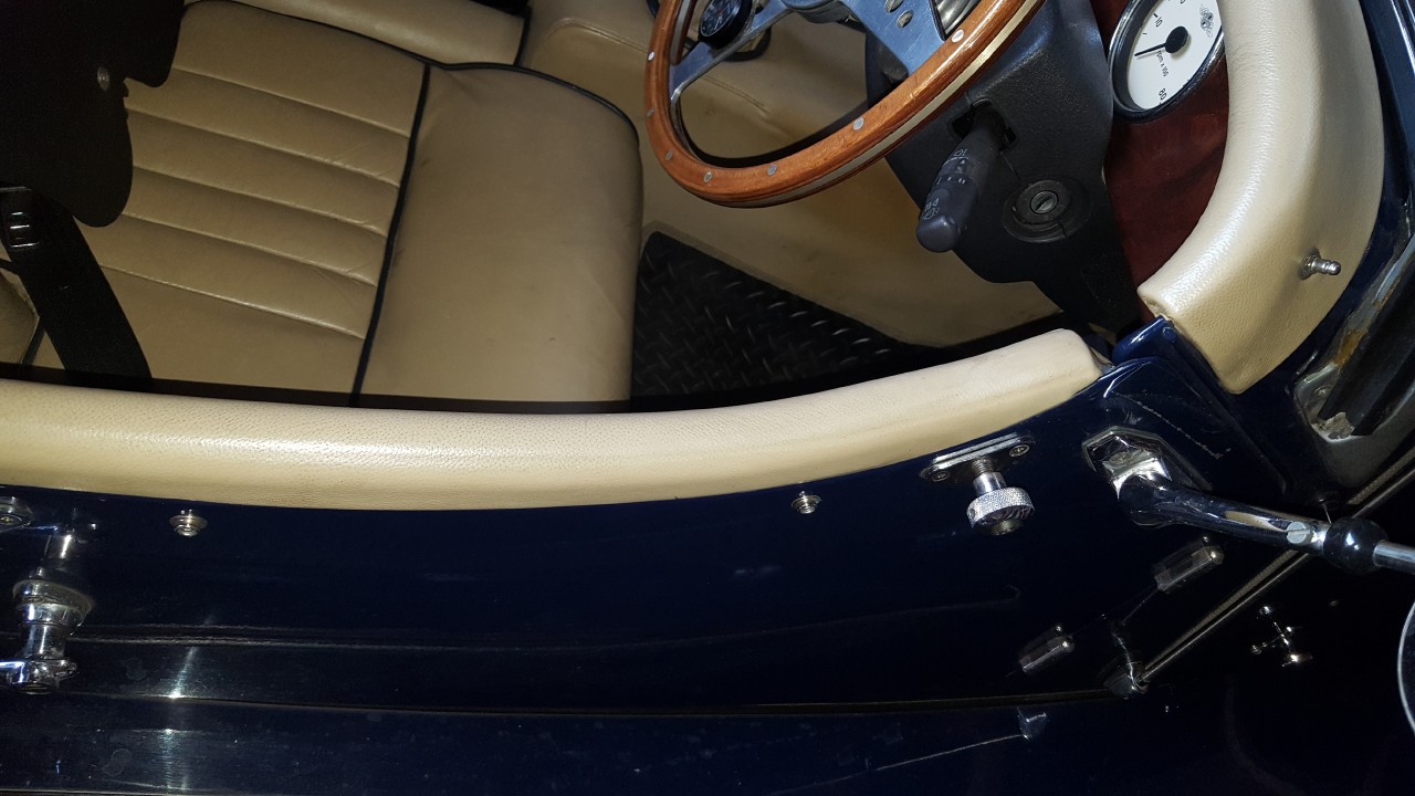

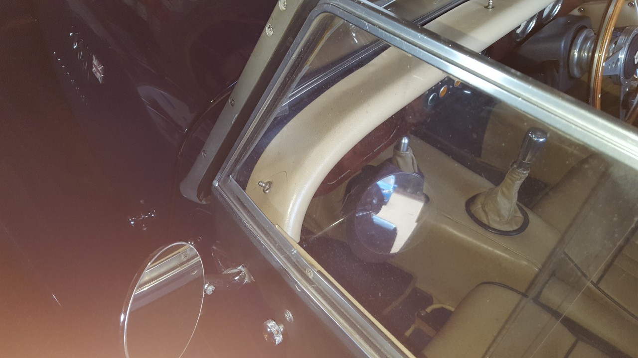

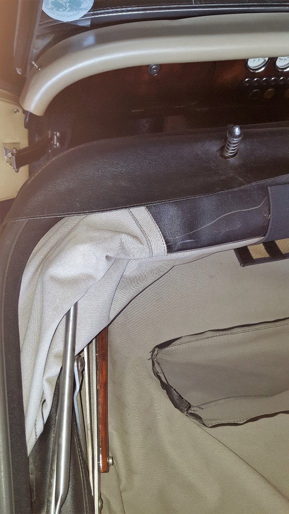

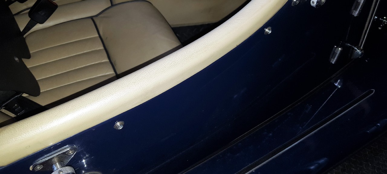

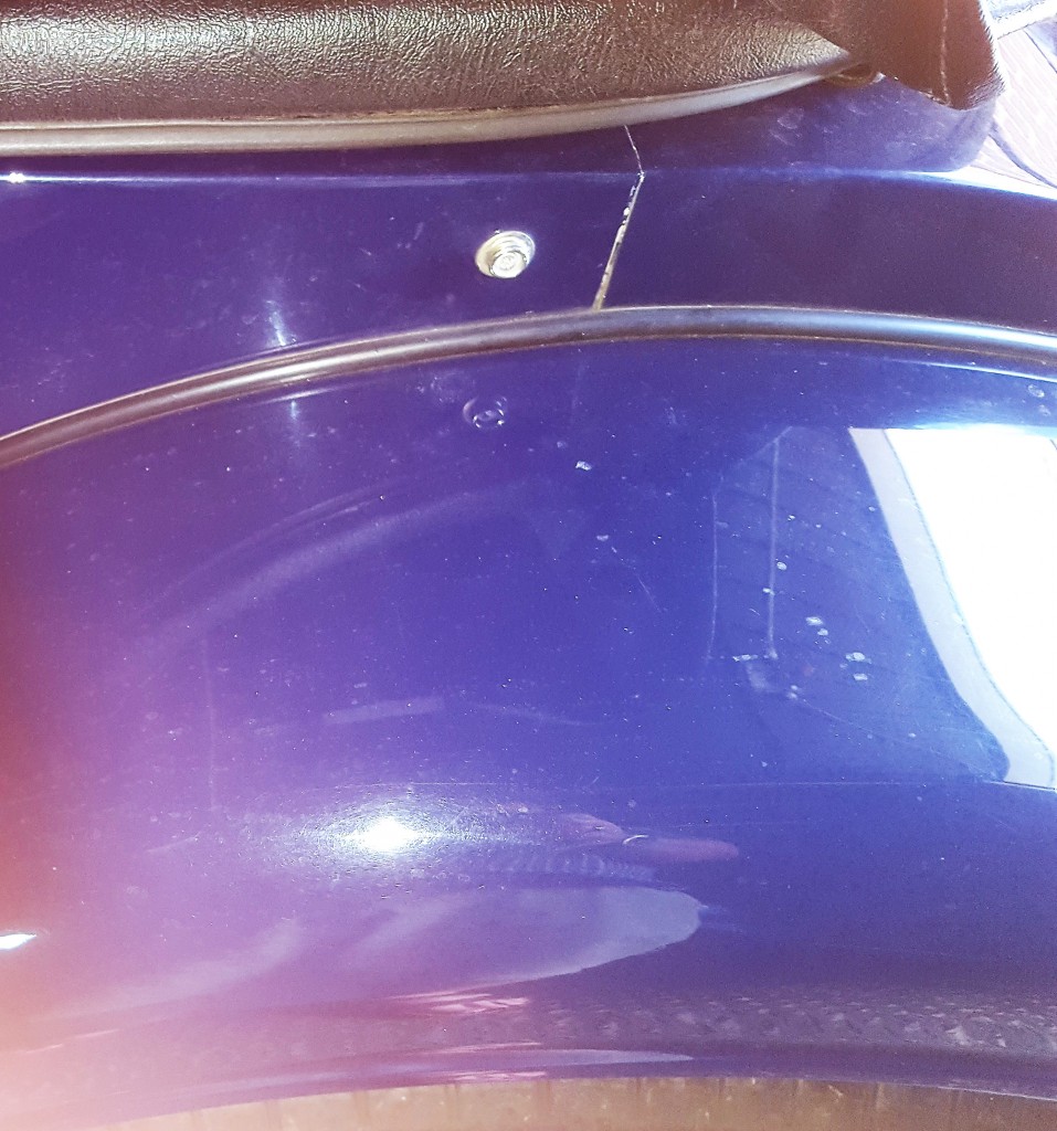

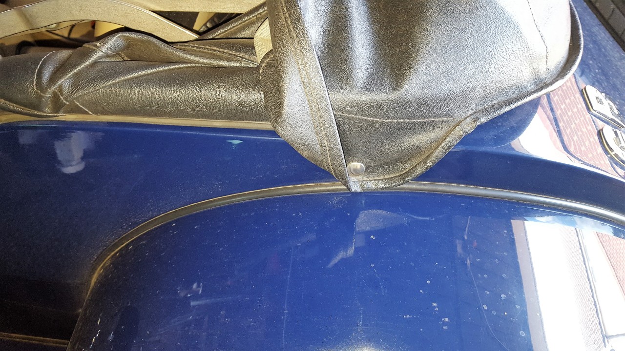

There are 2 more lift a dot studs on the scuttle either side , just like the one in the middle of the windscreen. There should be press studs on the doors.
Posts: 27,810
Posts: 27,810
Here are some photos . Not great quality as of my phone.
