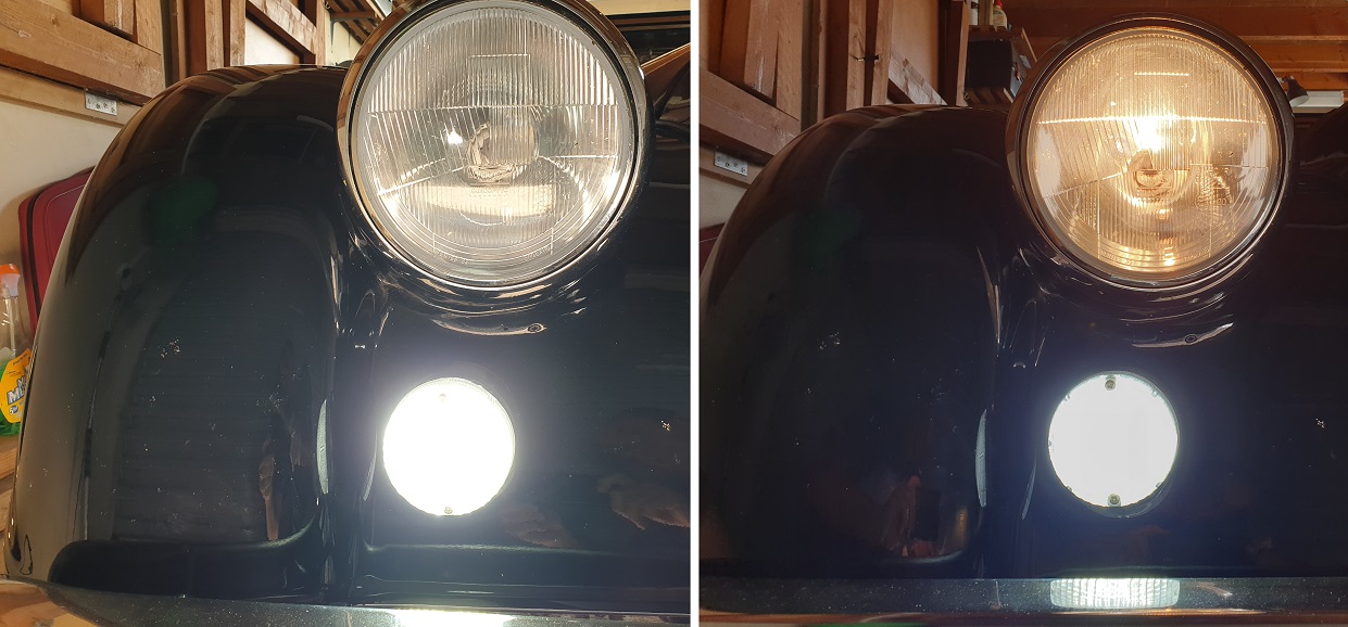

I have ordered two of thesefor the wing bullet side lights. I will let you know how Iget on
https://www.classiccarleds.co.uk/pr...b989?_pos=8&_sid=37526552d&_ss=r

Fitted direct swaps before and after.
The new bulbs are "really bright white" as opposed the the old "less bright warm white".
Just for the picky the headlight brightness is the same its just my camera angles.
Now it is my intention to transfer the bullet lights live live to an "ignition on only" live so lights are always on when ignition on and then also to fit the gizmo I found on ebay (earlier in thread) which senses dipped headlight on voltage and then reduces power to the new DRL bulbs.to comply with DRL legal requirements
In terms of an ignition on live take off point any suggestions for an easy to get at scotch lock wire?
Cost so far £11
Keep you posted
Ian[b][/b][color:#FF0000][/color]
