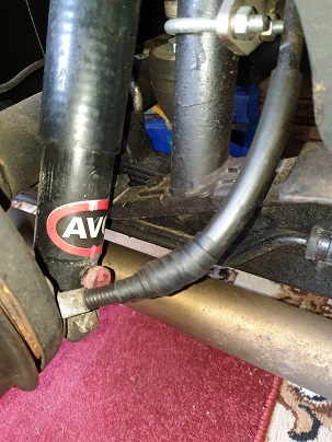

Well done. Looking at the photos your brake cable is rubbing on the hoop & rusting. I would cover that with split bit of tube after treating the rust.

John, you're absolutely right. My son has already criticized the problem. It's a good idea of yours to add some hose coating to these chafed areas for protection. After I remove the rust.

I used some of that magic tape suggested by Bernt to keep the water out of my damaged cable. Its holding up very well.
My first choice for many purposes!
in my workshop I use this "rubber splicing tape" (offered by many comanies) very often. You can wrap it around tubes, cables, wires and so on!

Thanks, Roger, a good advice re the damaged cable!
