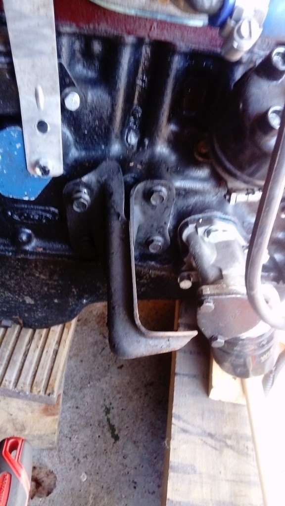

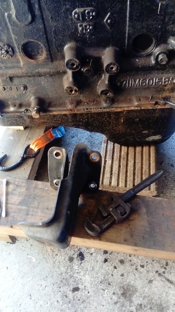

Here's some pics of the engine mounts I took for reference when I was stripping mine down .... one of these each side of the block then a rubber donut then another pressed steel mount to the chassis.
If you want better pics of the mounts let me know and I'll take a couple when it's lighter tomorrow

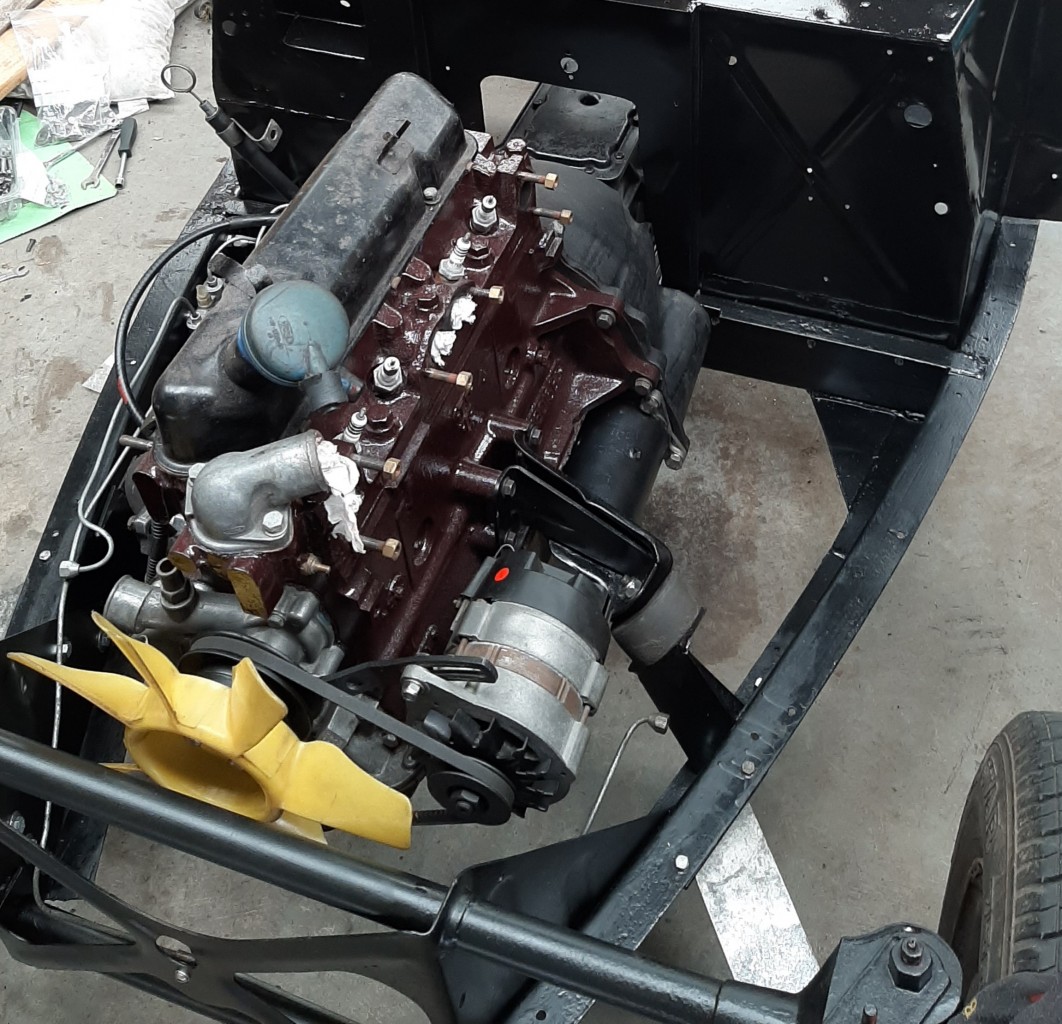

Thanks ,The pictures are fine and i am glad i asked as i have nothing like that .Something else i have to source ! nice 711 engine.!

There's all sorts of pics that might be good for reference on my sort of build blog thing in the 'Morgan Gallery' section .... there's likely better build blogs if you're willing to delve back into the archives .... look forward to seeing your progress on the rebuild.
