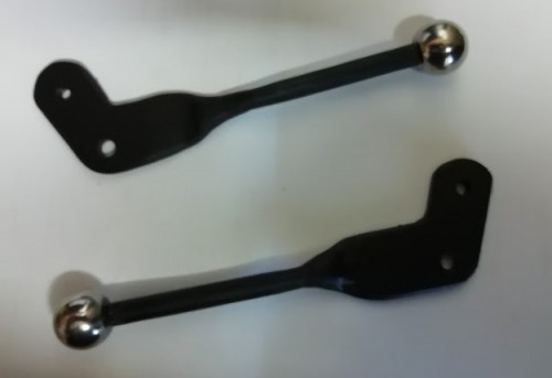

As there are no swivel pivots available for the 4 seat, I decided to make my own. Phoenix Designs used to make a set, so Jon was kind enough to send me details of them,.
I made a few adjustments to his design - on mine the top bolt hole on the plate is threaded, I can unscrew the bolt to drop the hood, and then screw it back in when I've tensioned it back up Ordered a couple of stainless thumbscrews to make it easier.

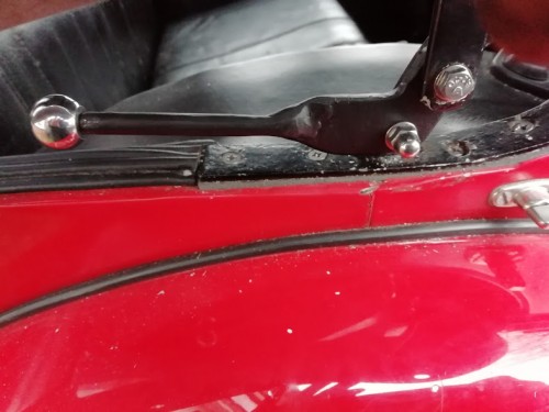

I feel your pain - was almost impossible to get the last couple of front end fittings connected when the hood was cold. With my new pivots it's a doddle.
Didn't use plungers as they stuck out too far and as they were metal was worried that they'd rub through the hood.. Used some bolts with plastic thumb screw style ends so I can tighten/loosen by hand and they won't damage the hood. Example in pictures:
