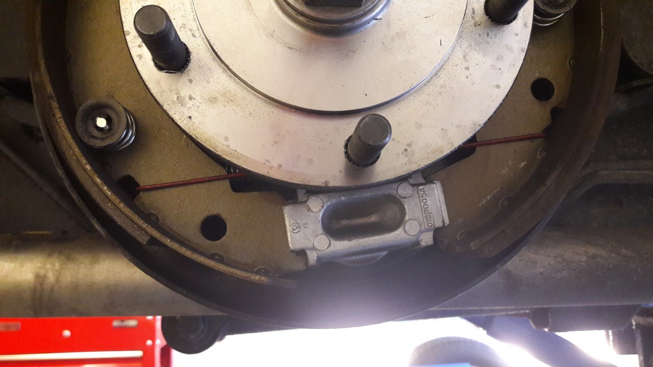

As others have said, fine splines & tight friction fit, you need to investigate any looseness or play
This is a rear hub shot, from servicing last year & you can just make out the edge of the splines around each stud hole
