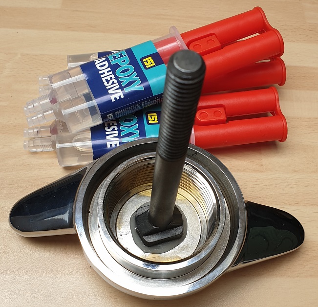

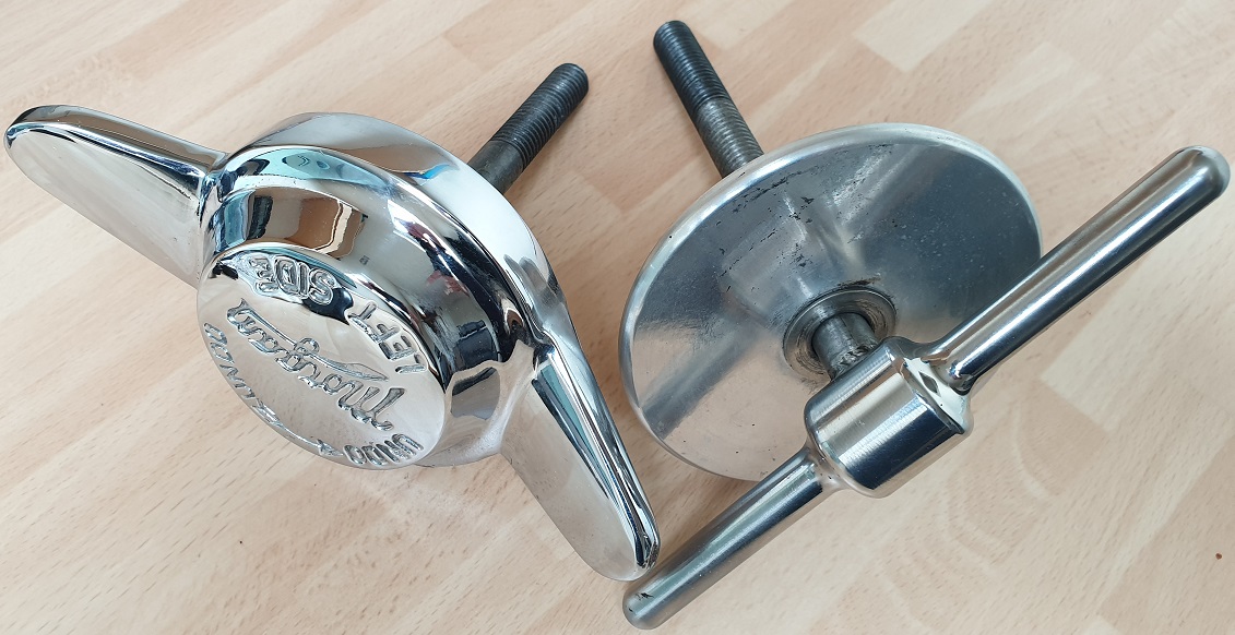

I’ve had this spare spinner kicking around for ages along with a desire to somehow use it to replace the tap handle arrangement that clamps my spare.
So I gave it ago this week....

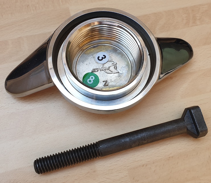

First find a suitable bolt. This Tee bolt was perfect.
Pre tack the bolt in position. Important to get it absolutely centralized and perfectly upright.
Acquire a few tubes of epoxy resin from the local pound shop.

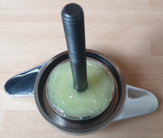

Fill the cavity. Not the prettiest of potting but it did set really hard and glass like. I don’t think the bolt will be detaching any time soon hide

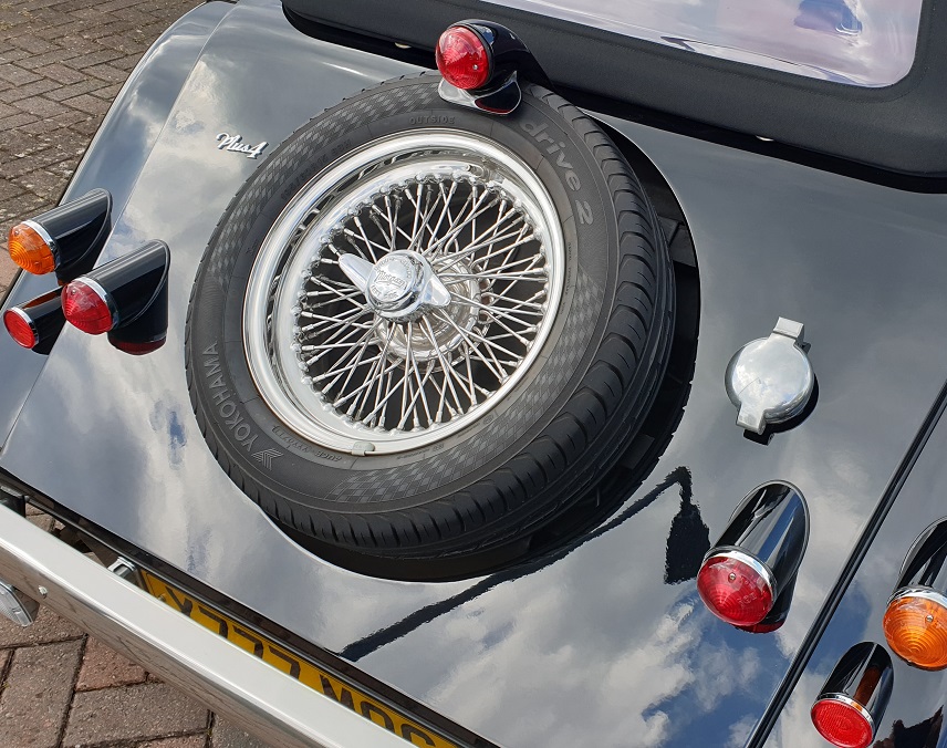

But if you do find a spare wheel laying by the side of the road it might just be mine laugh2
If you continue to fit the spacer thing then it won't be coming detached. In an extreme potting failure mode, it might rattle a little but it won't fall off.
