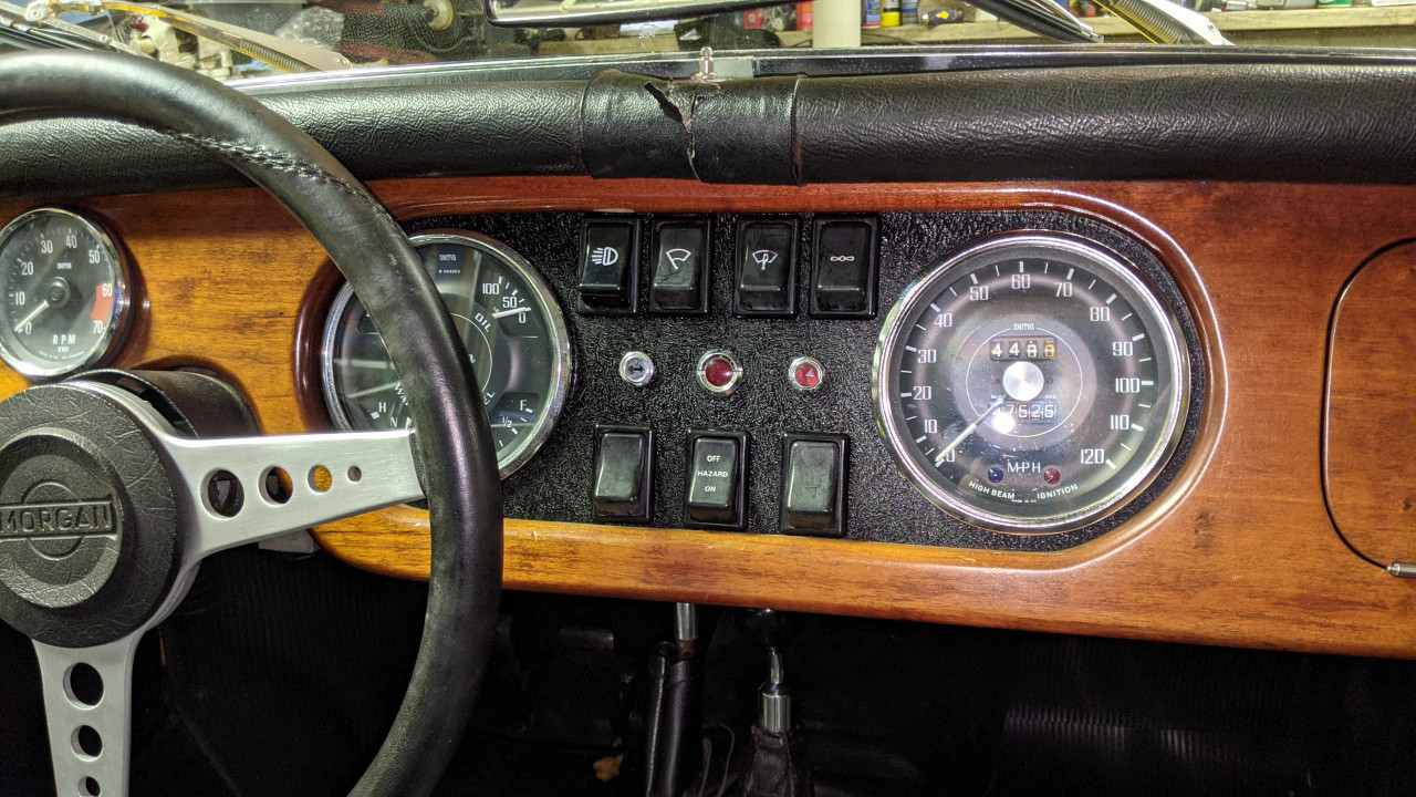

I followed the directions on GoMog. 3 coats of paint, then let it sit for 20 minutes. Nothing happened. I thought I had another failure.
Then into the oven for 20 minutes, and .....WOW!
Now I want to crinkle paint everything!

Good job Pauly G. thumbs I remember the first time I used it many years ago, I too expected failure, the oven makes the difference...as long as you don`t get caught doing it .. smile
I wanted to use Sperex yellow on the exhaust but try as I might there was no way of getting them in the oven laugh2
