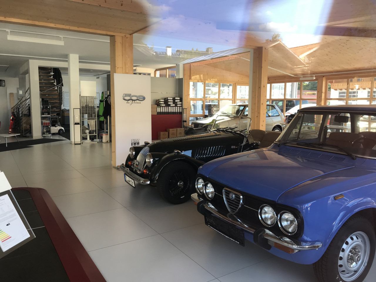

Still not sure if it will be success next time.
Atthe moment we focus on a thermostat and hopefully I`ll get her back on Tuesday...
But I suppose the have got smething wrong in den wokrkshop - it is not for sale...

Very nice ALFA…
Greets René
