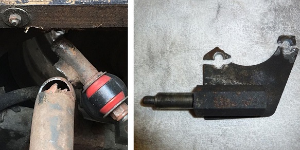

Agreed Rog. I think if you did do that to the shocks you should ensure you have the later hanger design but you could be over stressing the hangers. Mine broke on my S1 Roadster under load & I replaced both sides. Your bump stops then helped as well.
Old hanger
New hanger

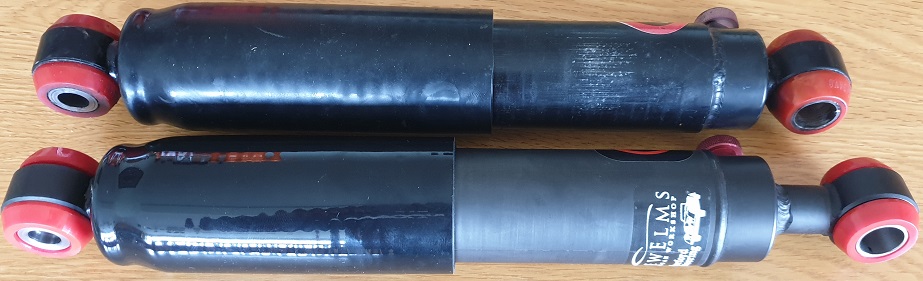

I recently got a pair of Tim’s “Rutherfords + 20’s” to try. With the pair that came with the car, the driver side was topping out before full axle extension so the attachments were taking the impact.
Old and new
