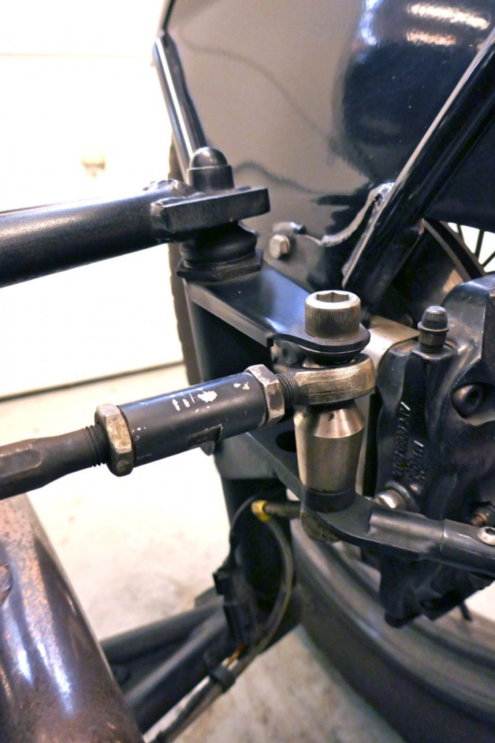

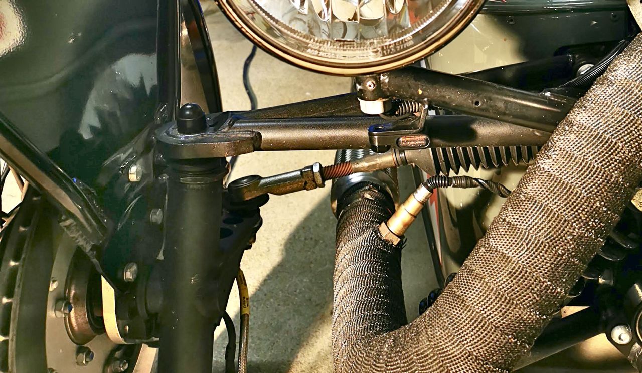

Originally Posted by ebetec
I will do a lot of further improvements and hope to finish everything end of winter season 2021/2022!
Eddy, your car does indeed seem to have avoided any of the various upgrades during its life.
For instance, I noticed the acute angle of the steering arms:
Most early owners found that this leads to quite severe bump steer - to the extent that the cars could be dangerous to drive.
Therefore, under pressure from owners, MMC introduced a 'Comfort Kit' which is basically a spacer set to reposition the track rod ends to keep the steering arms roughly horizontal.
This results in a much calmer driving experience (!) and I recommend that you speak to your dealer about having this modification done.
I also recommend that you read the Buyer's Guide which is available as a free download from the Morgan Three Wheeler Club website. This will give you a good understanding of your car and give you pointers as to the work needed to produce a reliable vehicle.
By the way, I do like your minimalist front indicators! thumbs
Andy

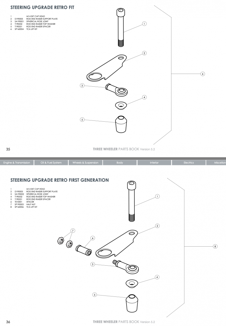

I already ordered the "empire racing suspension upgrade kit" at Krazy Horse in UK ... I thought this should solve all the problems with the original bad construction of the stearing from MMC - isn´t it?.
Do I have to implement the "comfort kit from MMC" additionally?
I suspect they don't include the spacers as standard because the majority of cars either have the Comfort Kit fitted already, or have the later uprights (post 2014 chassis) so don't need it. Therefore, I would contact Krazy Horse and ask them whether the comfort kit components can be included with your Empire Kit because you have an unmodified early chassis.
You will need one of these Morgan kits:
...probably the 'first generation' one. Remember that the conical spacer (item 4) goes ABOVE the rose joint, NOT below it as shown in the diagrams!
