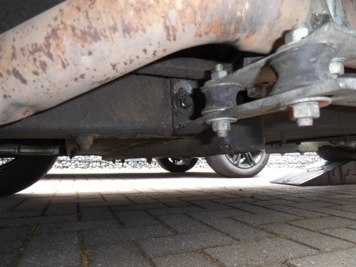

Always had a strange rattle in the exhaust of Matt-Mog our 2014 +4. I thought a leftover piece of welding wire, couldn't see anything wrong on the outside of the exhaust.

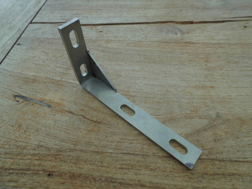

But recently the sound got duller. Especially at idle. So check it again. And yes broken bracket.

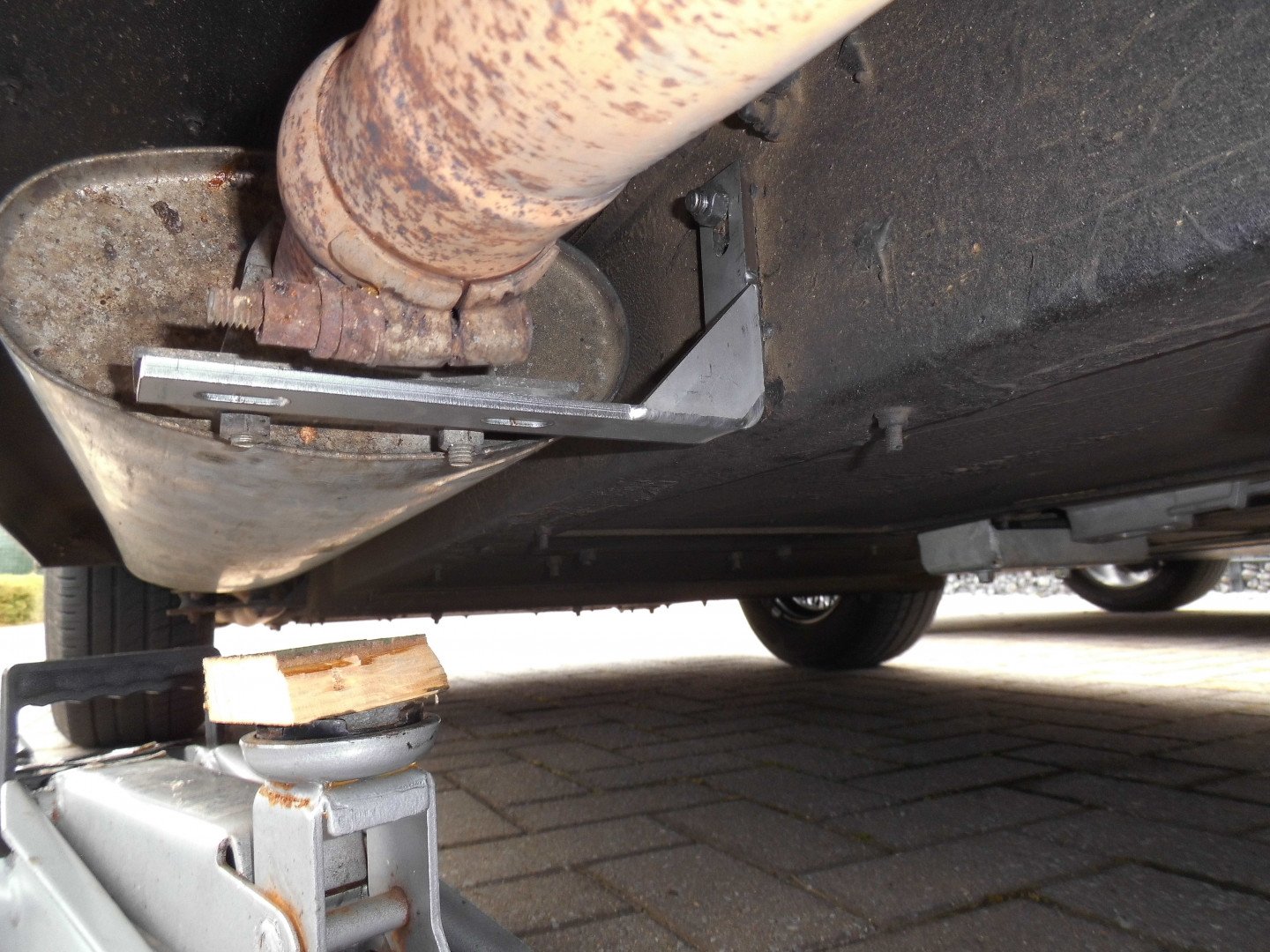

A quick provisional repair was necessary. Under the workbench I found something that with a small adjustment could serve as a temporary solution.
In the second photo you can see that on the left side the fracture is stil fresh, no rust.
The other side must have been broken long ago. There from the rattle?
Let's see if Belmog can provide this support? Otherwise DIY I assume???

MATTMOG #714889 20/08/21 06:41 PM
Joined: Dec 2020
Posts: 279
Likes: 57
MATTMOG Offline OP
Joined: Dec 2020
Posts: 279
Likes: 57
Installed new exhaust bracket, was not a straightforward job.
https://www.tm-img.com/images/2021/08/20/DSCI0419.md.jpg
With the bracket in lowest there was no room for the rubber bobbins.
https://www.tm-img.com/image/3elqw
Everything had to come loose, including the U bolt and the bracket at the back.
Then jacked up the exhaust a bit to get everything straight.
Lower the rear bracket a bit and then it worked.
https://www.tm-img.com/images/2021/08/20/DSCI0423.md.jpg
Everything reassembled but not tight. Will see the next few days if thing needs to be adjusted.
On the (test) drive to the circuit everything sounded normal.
