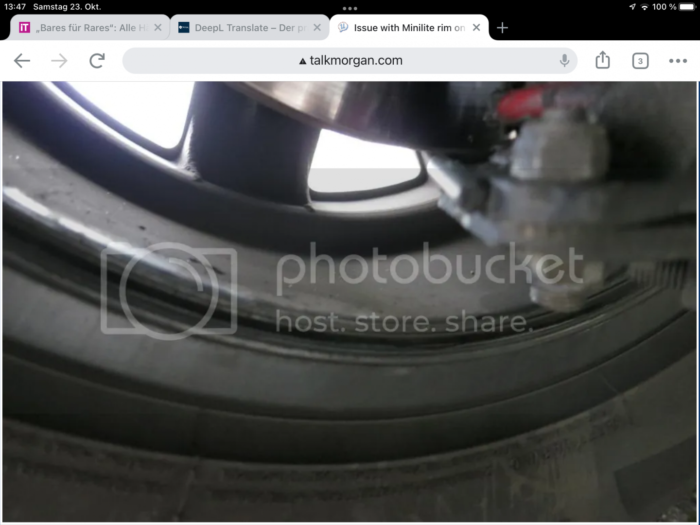

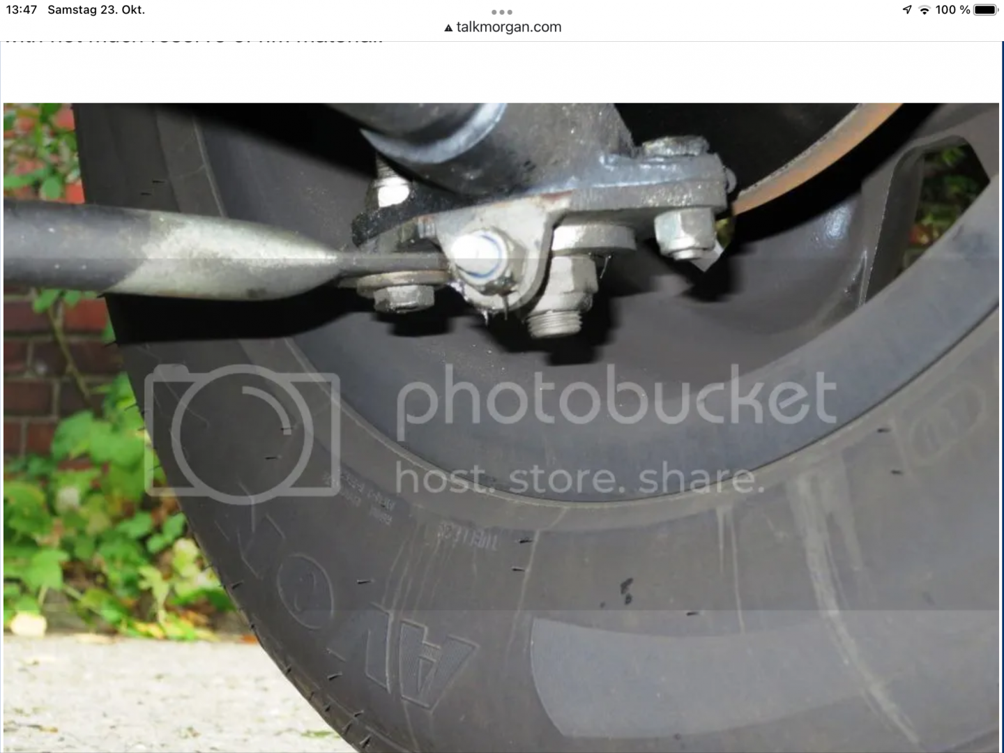

I would like to agree with Axel on every point. We weighed the rims of my Plus4 Supert Sport without tires back in 2013 at Morgan Flaving in Unna. It was frightening how heavy these minilites were. Approx. 11.5 kg if I remember correctly. A normal spoke wheel for a Plus 4 were 7.5 kg light. In addition, a center lock wheel hub weighs less than a bolt on wheel hub, we compared the weight at Flaving, I remember 1.3 Kg. or so in difference. Ok, this is not sooo relevant because there are no rotational masses outside on the wheel. That's why I wanted to upgrade to 5 hole wheel hubs. I had even discovered a company and a rim model which I found attractive. Funnily enough, it happened to be Image Wheels and exactly the rim that MMC later used for the ARP4. Only, all in all it was a very expensive conversion and I left it. Of the existing MMC wheels with central locking only the stainless steel spoke rim fit in terms of offsets, but that is just such a weight monster and it does not fit visually to the P4SS.
The weight problem of the Minilite was twofold. One is that the rim is very heavy. But the biggest weight problem is the adapter needed to go from 5 bolts to center lock. The other point Axel mentions is grinding the inside of the rim on the camber plate. This was the case with me, very dangerous! The rim had hardly any material strength and could have broken at any time. So my P4SS went back to the factory in England under warranty There, a kind of "workaround" was made with some rubber stoppers that prevented the deflection and I got new rims for the front. That was an ok solution but not a smart one.
All in all, I found that the (visually very nice) Minilite rims were a serious problem point on the P4SS and I can well understand that Axel finally has rims without this monstrous adapter. For the same reason (and perhaps for originality), Stefan from MSCCD opted for 5 bolt rims when developing his Baby Doll, which Morgan then rebuilt in a small series.
A new Minilite P4SS wheel
My wheel after just one year of just road use but I could not notice the dangerous grinding when driving.

Irrespective of where the extra mass is outside of the suspension, it all contributes to an increase in unsprung weight, in turn reducing suspension compliance.
