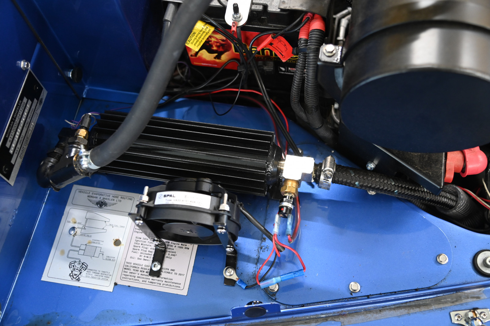

This is the set up I have for cooling. all the oil goes through the cooler, but because of the location, it is not really an issue during a cold day. The thermostat kicks the fan on when the oil gets about 210 or so. I have a red light in the cockpit to indicate the fan, and a thermostat as well. As a lot of my driving is going up and down the Appalachians, it does not take much on a cool day to heat up the engine.
Neat install... but perhaps you need a good old hood scoop to feed it fresh air, then some air out louvres in the bonnet smile

it does have louvers, but yes getting more under the bonnet it a good idea. I thought of sucking air from the passenger foot well could even reverse the fan in the winter to heat the foot well. I would hate to have to repaint if I installed an air scoop
