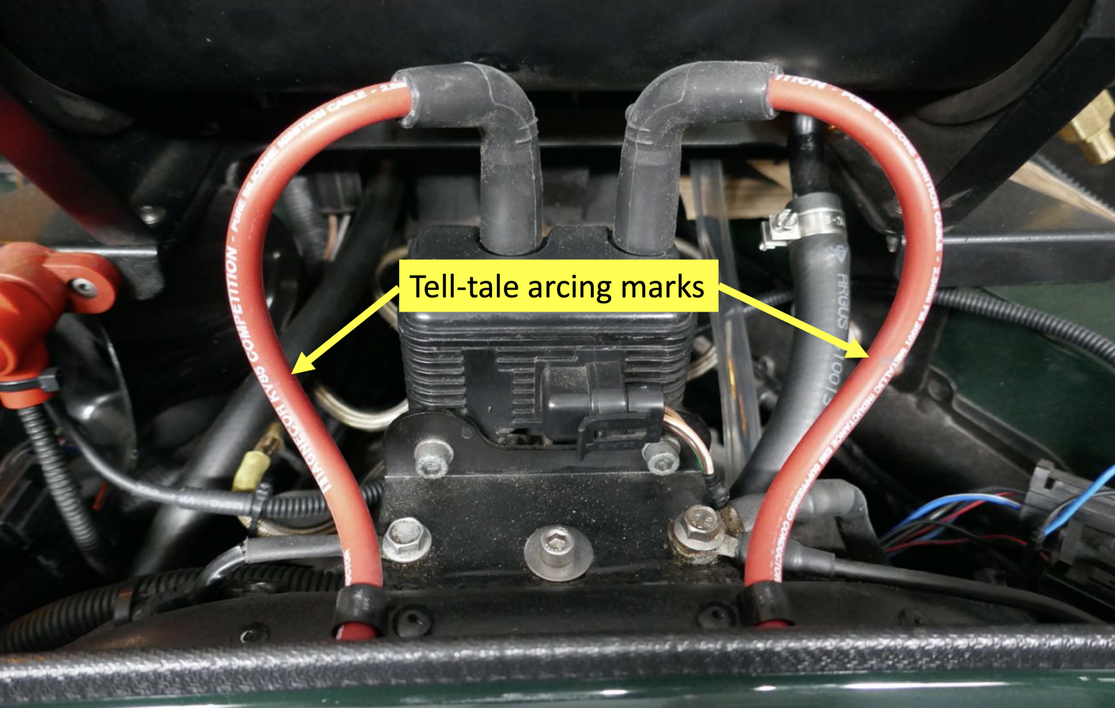

bad gas? (given how inconsistent the rough idle is?). Some of the NGK DCPR7EIX's are sold so you can remove terminal. If you order them online you take your chances. At the counter of an auto shop, be sure to open the box and see if the terminals can be screwed off. I was told to use these "threaded terminal stud" with spark plugs in this pic
https://www.ngk.com/spark-plug-terminal-types
The upgrade Magnecor plug wires --the Magnecor part number 2547 WIRE SET - "KV85 COMPETITION 8.5MM CABLE FOR 3 WHEEL MORGAN M3W" is a modest upgrade and they come with their "T17" threaded stud meant to fit tightly on the plug. You can order a set of these for 65 bucks in the states in Michigan here:

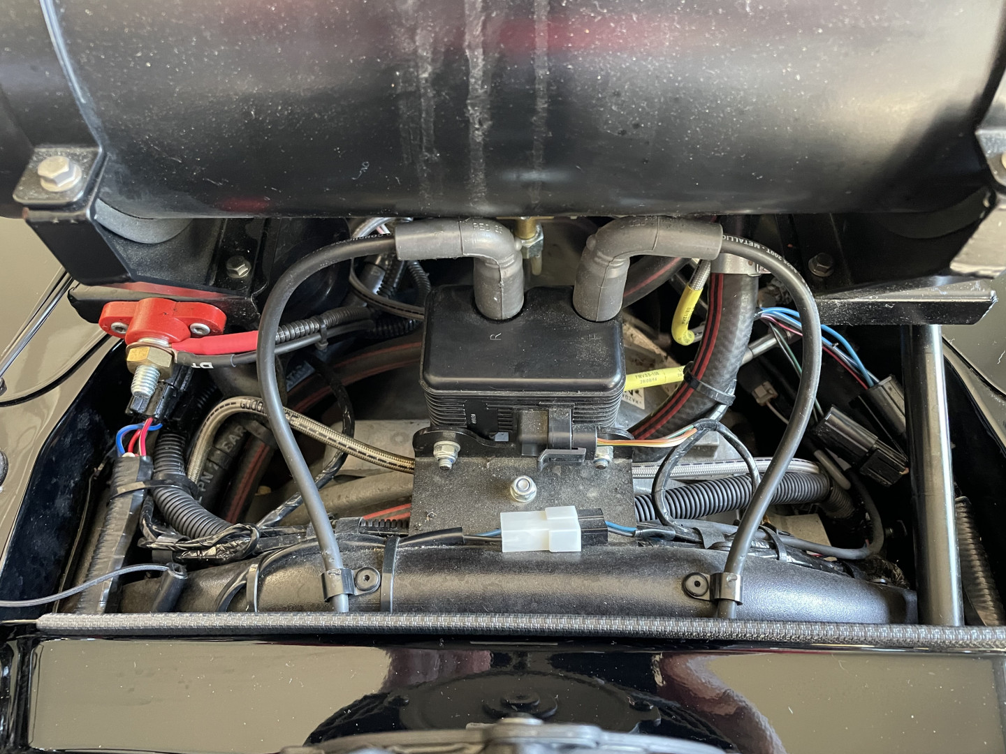

I am replacing the stock spark plug wires ( Magnecor 7 mm ) because someone placed my lead wire boots at the ignition coil terminals parallel to the oil tank ( see pic below and yes I know there is a small leak from the oil tank cap. I’ve replaced it once per previous recommendation to do so because of disintegration of the original gasket ) and the heat from the oil tank partially melted the rubber boot in contact with the reservoir. This can damage the insulating material around the wire and compromise the integrity of the electrical connection. Most people in this forum went to the Magnecor 8.5 mm wires when they replaced their wires and that’s why I went with these. I would suspect spark plug wires are a common cause of a poorly running engine but frequently overlooked. Over time the receiving terminal that fits over the spark plug terminal inside the boot can become loose causing an erratic connection which results in sparking and carbonization inside the terminal and reducing conductivity. I’m going to replace my ignition coil as well. So new coil, wires, and spark plugs with fixed terminals. I feel my battery, rectifier, and alternator are ok because my voltage is at least a steady 14 volts under load.

Someone placed my lead wire boots at the ignition coil terminals parallel to the oil tank.
They probably did this to prevent the leads from chafing against the underside of the hood cowl. There's not much clearance there.

The right one is touching the tank it isnt good
Imputer away mine

I don't think that the ECU monitors or records fuel injector pressure. The only indication of low fuel injector pressure is that the injectors max out to the limit in an attempt to maintain the correct mixture in closed loop operation. You will get a "check engine" light and a fault code listed on ProTune 2 when this happens. There is a Schrader valve test point on the RH (rear) injector to test the fuel pressure, it should be 58psi, that is the only indication. If you have not replaced the original fuel pump with a Walbro item, do so. The original pump will fail if it has not started to already, it's not a big or costly job and will save you a lot of time chasing problems.
I suggest you route your new ignition leads under the chassis tube they are presently P clipped to. They tend to rub on the top cowl edge, as yours appear to have done near the P clips. Some extra spiral insulation helps where things get close.
