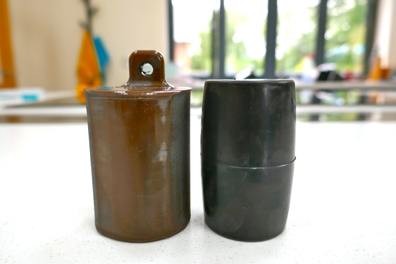

Just a reminder that if you are changing Bleazey Polybush Centa 'rubbers' to the standard MMC rubber ones, they may need trimming to length.
As you can see, the MMC ones are around 3-4mm longer than the Bleazey ones. I trimmed them to around 59.5mm length which makes them snug in the Centa while still allowing them a slight amount of movement.
My Bleazey conversion was fitted in August 2019 and I have been told that later ones can accept the standard rubber rollers without modification. I'm sure that Phil can let us know when this changeover happened.
Andy
Andy - The MMC rollers do not need to be trimmed for the later upgraded Centa's.
In fact the MMC rollers are a more snug fit than the PB rollers from new in the later Centa's.
The PB roller you show is the original Brown coloured type which are no longer manufactured by Phil. I would see what the difference is between this brown and the later black speckled roller in dimensions but we no longer have any of the new PB rollers in stock as all have been returned to Phil as we only fit/supply MMC rollers now.

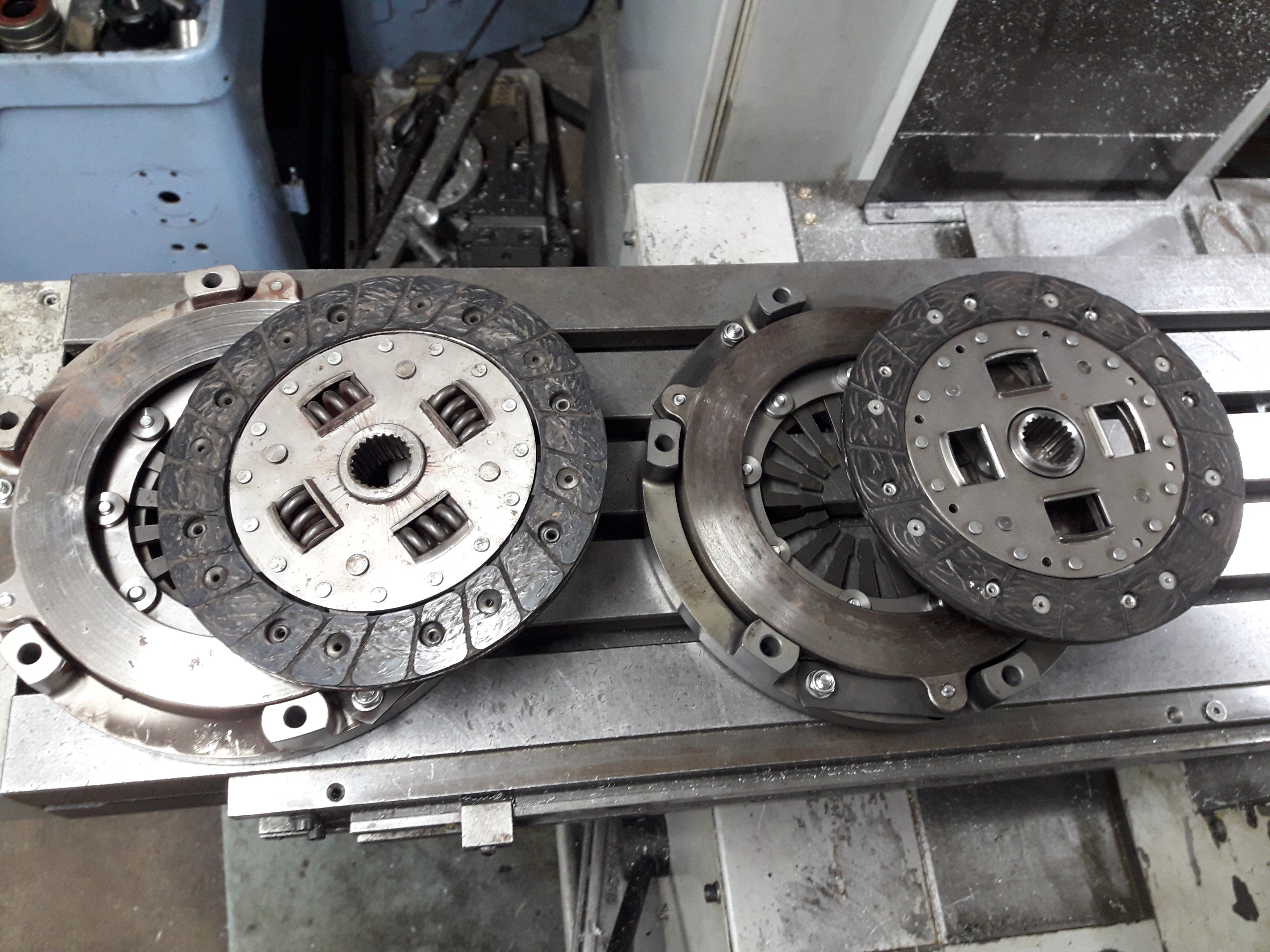

I took the opportunity to rotate the shaft in the centa housing and I heard again a small metallic noise during rotation, I guessed again that the clutch disc springs were broken.
this makes the second clutch disc with a broken spring although the thickness of the clutch disc is close to new, I think there is a quality defect, I still have the original clutch which is of different design and is still in good condition with 60,000 km, it will be ridden for the third time.
I would also like to point out that the starter crown is not eternal I have already replaced it once with the starter, the machining of the teeth and the quality of the metal is not the best, I am still looking for a 112 tooth Mazda crown or others to repair my old flywheel.

The previous flywheel had broken teeth.
the new flywheel was reassembled with a new MMC starter, the quality of the teeth is less than a toothing made of XC48 steel with heat treatment fitted with the cast iron flywheel.
the second clutch disc in perfect condition broke a spring and lasted as long as the centa rubbers.
I'm going to reassemble my first 2013 clutch disc which must have 60,000 km
