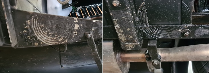

Where do you place the lifting pads on your Morgan when using a two poster car hoist

Under the broad part of chassis at the front just behind engine mounts and at outer ends of square section cross member at rear. It may vary if distance between front and rear mount options on your two post lift varies greatly from my Automotech scissor lift though.
I don’t but I do have tell-tale marks
Roger

Thanks Richard &Rog with such a light chassis you don’t want to get it wrong and we are a long way from spare parts
