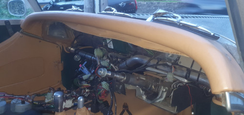

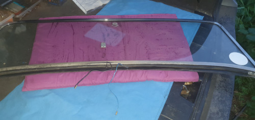

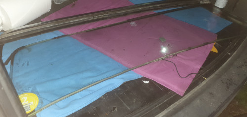

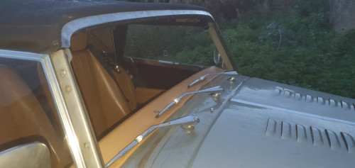

With the wheel out the way, it makes sense to tackle the intermittent stuck key in the ignition with a replacement from G.E.E, replace the pitted windscreen with some new laminated (though not heated) glass, and finish off the heated seats with placement of relays and wiring; just hope I can put it all back together for the Edinburgh trial in October!
Surprisingly simple to extract and deglaze the windscreen.

Seems there's plenty of watchpoints to look out for. On mine, both screen retaining screws are the same length, although i've coded them to be safe. Also only one brass screw each side for the frame. Minimum goop in the channel too. Off to the glaziers with it today, so hopefully back in on the weekend. Terry's a great source of knowledge and tips- I don't think I'd tackle half these things without his guidance. He's als repairing my boss to retain as a spare, and supplying a new ignition mechanism. Highly recommend him for all things Morgan, from chassis up.
