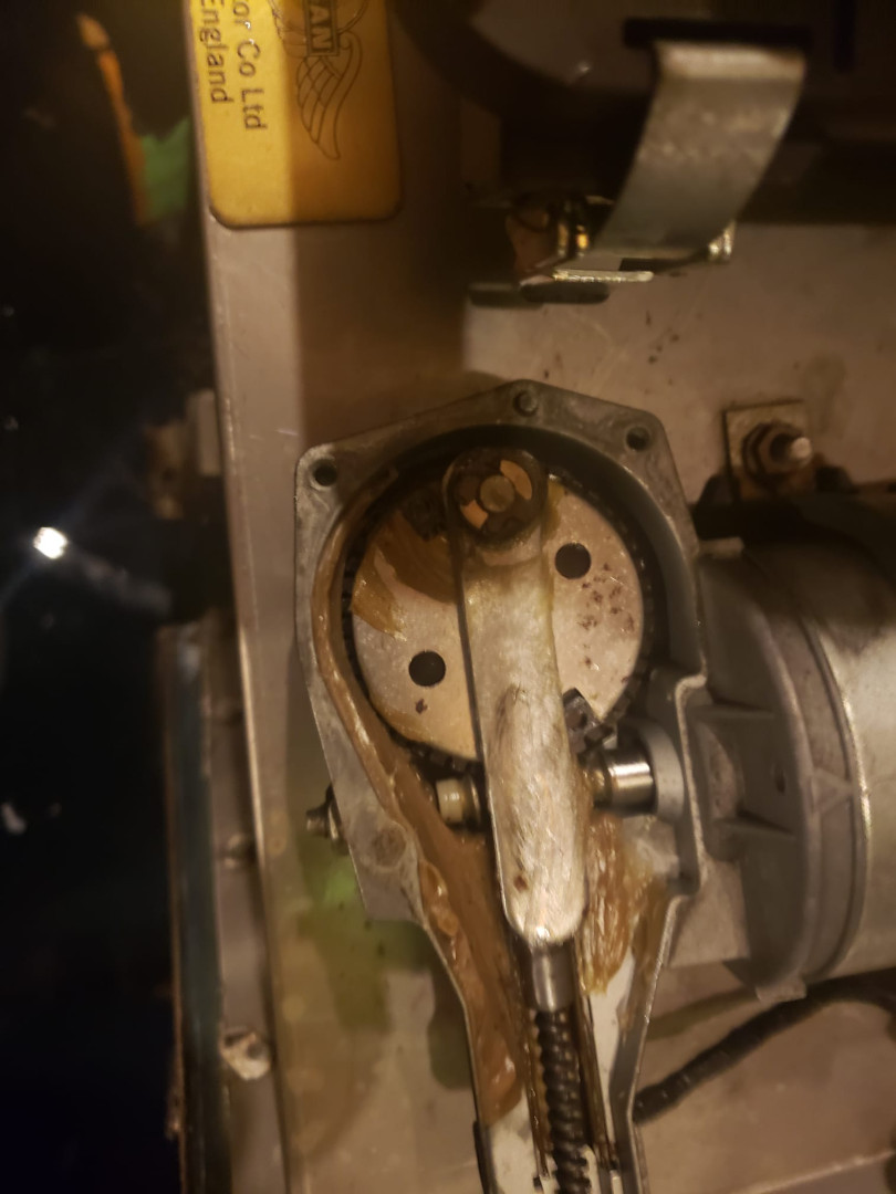

Chris, mention of your wiper fuse blowing has me thinking it may be caused by a stiffer than normal linkage and so motor drawing more current, initially at least. I know John V6 took the cover off his recently and found a parcity of grease in there. Might be worth a check and a reminder for me to practice what I preach blush
Had to do that with mine as the 'draw' had blown my smartscreen device. Stripped the cover/cogs, cleaned and regreased and did the same with the cable and the wheel boxes. Much better action now, and the new smartscreen is safe!

Good thought Richard. Also if the arms take the blades too far onto the chrome it can cause it.

It had been some months since the wipers were last used. Replaced the fuse and went for a test drive with wash/wipe on several times without issue. Next job is to check out both grease and blade clearance 👍

The gear box on my motor was really dry Chris. The dry grease was very strange almost like putty.
