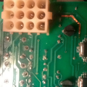

There’s an old TM image of a pcb that suffered from water damage or a short in the indicators. Can’t remember precisely but it burnt out some of the tracking which is shown here repaired. Quite an expensive fuse…
