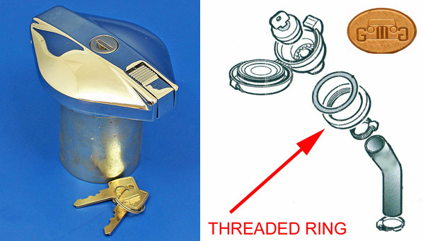

Both filler hoses on my 1990 3.9 Plus 8 are cracked and leak badly when re-fuelling. This could be due to age (or Ethanol deterioration?). The filler caps are lockable, lozenge-shaped and chromium-plated.
I have bought some new 51mm rubber hose from Hose Supplier. This hose is reinforced with a spiral spring bound into the hose construction.
It has proved impossible to install the new hoses because they are difficult to bend whilst aligning the ends with the filler neck and the fuel tank tube. I have considered removing the filler cap and neck and was surprised not to find a large (around 2 inch diameter) hexagonal fixing nut on the underside of the rear panel. Instead, I can feel only a plain, circular metal boss. Maybe these are unscrewed using a strap-wrench? I have checked everywhere for a clear photograph or drawing but have found nothing.
At this stage I would really appreciate advice from someone older and wiser:
1. How can a new stiff fuel filler hose be installed with the fuel tank and filler necks remaining in place?
2. If the filler necks should be removed first, how is this achieved?

I doubt super stiff hoses CAN BE installed. And why risk shearing the tank inlets? But removing the filler assemblies is
not difficult. There are rubber washers (if they are still there) and a threaded ring on the interior side of the fillers. Diagram
below. Forgive me the diagram is from a later 4/4 which is not identical to what you have but shows you how these assemblies
work.
If you want a source for proper cuttable, shapable fuel hoses, I am sure we can find something nearby. They are all the rage.
L.

gomog - The nice words you say about the 1990 Morgan Plus 8 are much appreciated. This is my third Morgan since 1976 and is probably the best though my wife really enjoyed our original 4/4 as her working car for shopping, school deliveries, MCC Rally etc.
Your illustration is especially helpful though I am curious to learn the tool you have used to remove the cylindrical 'nut' that classed the job as 'not difficult'.

Today I glimpsed via mirror and mouth-held torch the interior thread of the so-called nut holding my filler cap to the body panel. Now at least I know that all that MMC forgot to do was machine the 72mm A/F hexagon profile (reported elsewhere by some members) to allow the easy removal of these nuts with a spanner. My nuts are simply plain, circular collars offering minimal grip even defeating my chain-wrench. It's so b-----y awkward working in the darkened corner of an underbody void with torch, mirror and a racalcitrant chain-wrench.
I then attempted to fit the wire-reinforced hose I had bought but eventually gave up and placed a new order for 500mm of plain old single ply fuel-proof 51mm rubber hose. New Hose Supplier
Performing what should be a very simple task illustrates the effectof MMC's habit of changing build methods and parts specs at will. The lack of a decent Service Manual doesn't help, even on what should be just a simple job.
