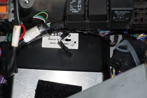

On the CS flash there is a label on the ECU that confirms the ECU has had the flash. I'll try and post a pic later.
Here's the pic, it's not a new label just changes to the existing label.
Cheers
John
Edit, add pic.
